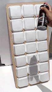

After having glued all the squares, use a ruler to mark the cutting area. If you don't have a ruler long enough, you can use a straight stick.
Step 9:
Trim excess and corner edges carefully
Step 10:
Now let's prepare the painting area. To avoid damaging your house or staining the area around your work area, place some plastic or cardboard to protect the walls. If you can do the painting process outdoors, I recommend it.
Step 11:
The chocolate bar will come half covered so you only need to paint 12 squares, although if you want it to be a display you can paint the whole thing, in my case I decided to save on paint.
To apply the paint we must retreat at least 20 cm and apply quick bursts to the burger boxes and cardboard, taking into account that the composition of the paint can damage the material, but if you do the process well what you will obtain will be a chocolate texture.
