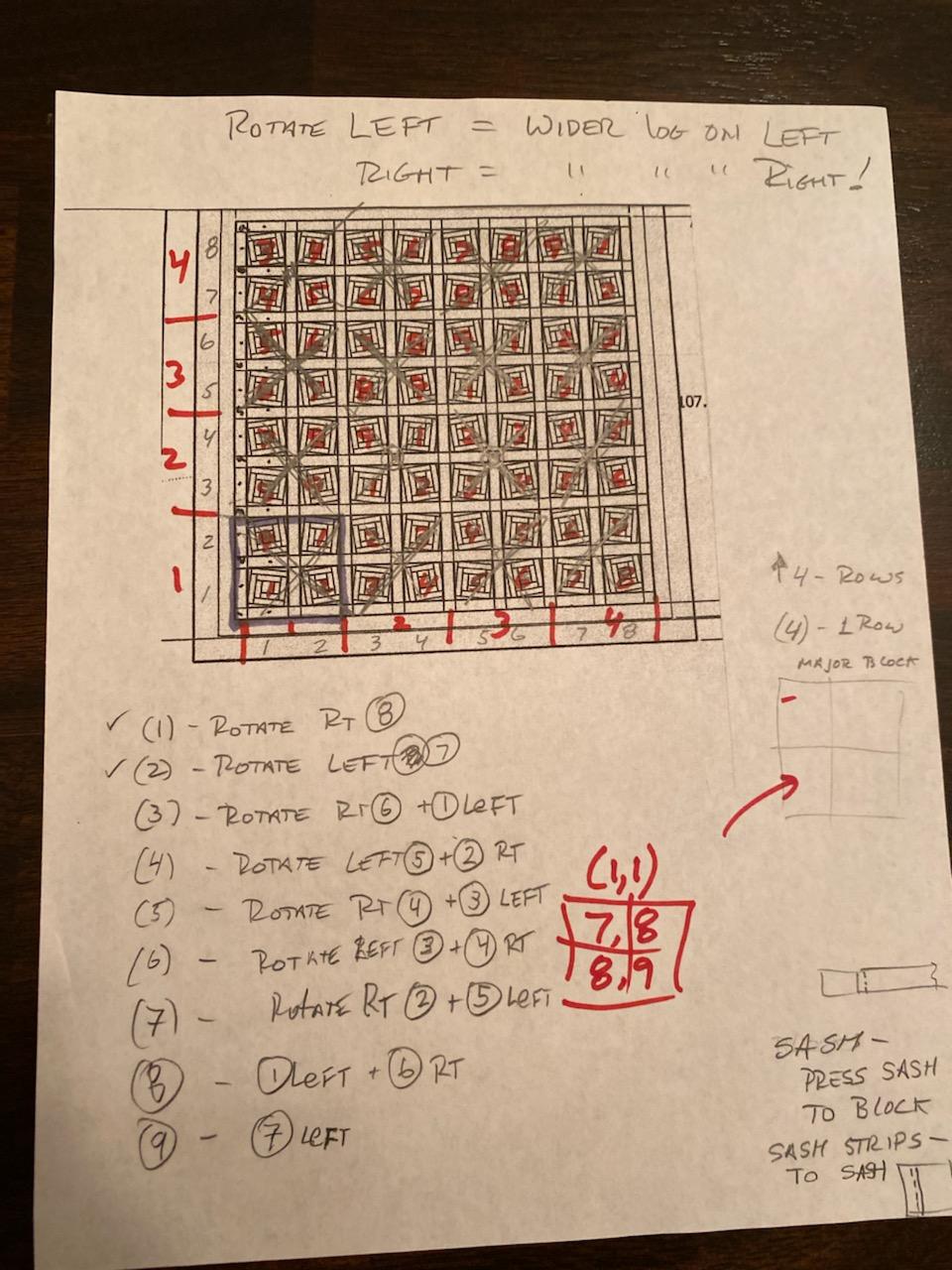

FIRST OFF - The patterns shown in the pictures are NOT in millimeters but in INCHES. The CAD software I drew up the pattern in had defaults set for metric and I didn't want to change them. Anyway, since the dimensions were in easy "full inches or half inches", it was easier to see and understand the drawing this decimal format versus fractions.
The design is based off a traditional LOG CABIN design. This is an easy rectangular pattern that has only square corners coming together (no points) which makes this a great pattern for first timers like me!
A basic Log Cabin has a nice geometric look to it that can be greatly exaggerated by how the colors are selected and laid out. Gradients of color can really make this look a lot different than mixing up fabrics as I did. But note that my fabrics have all the same tones to them and they play well with each other. In fact all of the fabrics I chose are from the same manufacturer from the same line - making this a very easy and cool way to get the look you want (low risk!).
BUT - a basic log cabin was not for me! I wanted a twist to the pattern so I made it "wonky" style. This means I took the basic log cabin BLOCK, then rotated it to the left just a bit to allow for the most outside "logs" still to have some coverage in the block (approx 8 degrees).
Study my drawings to understand that there are multiple pattern repeat frequencies in this quit.
- Minor Block - 9 total different blocks before it repeats. Hence no two blocks are the same on any row.
- Minor Block Wonky Rotation - Every Other block goes "Wonky" in the opposite direction. No column or row has the same wonky next to each other.
- Major Block - Consists of four different minor blocks - 2 different wonky rotations. Not two alike in a row or column. Identical Major Blocks have a strange repeat pattern that actually overlaps itself. Can you find 7 major blocks throughout the quilt that are identical to the first in the lower left hand corner?

I would suggest to sew ALL 64 minor blocks before cutting for wonky.
Wonky cutting is OPTIONAL. I just wanted another dimension to my quilt so I decided to cut half of my blocks on a slant to the right and half on a slant to the left. To do this I made a custom square clear ruler out of acrylic sheet 1/8"thick. It was exactly 10.5" by 10.5" so the finished block when sewn would be exactly 10" x 10" . I basically placed a non-wonky cut block on my cutting board and overlayed the acrylic square on top of it but at an angle to match the outer most log to run to a point on each of the four sides. I then used the rotary scissors and cut the block square. Then I assembled the minor blocks into major blocks (4 minors each).
