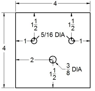

Step 4: Making the Base Plate
Cut a 4” x 4” piece of ¾” piece of wood.
Drill the holes as shown. Each hole is 3/8” deep. Pay special attention to the 5/16” holes. Do NOT allow the drill point to peek through these holes because they have to form a pool for the glue or epoxy.
After the base plate is finished, you may want to consider adding any cosmetics desired such as sanding or routing the edges and paint/stain.

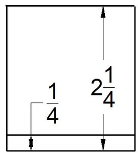

On a ¾” piece of wood, draw a rectangle, 2” x 2 ¼”. Do not cut anything until the directions specifically tell you to.
Draw a line 1/4” in from one of the 2” sides.

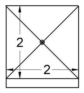

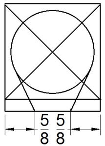

Step 7: Mark Wood Ring Center
Draw lines corner to corner on the 2” square. Make a mark for the center.

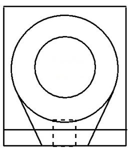

Step 8: Mark Mounting Hole
Make a mark 5/8” in from both sides on the bottom of the 1/4" side. Draw line from each 5/8” point to the side of the circle as shown.

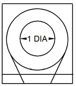

Step 9: Drill Center Hole
Using a 1” spade bit, set the point in the center mark of the 1" hole and drill the hole in the center of the circle. Only drill about half way through the board. Now flip the board over. The tip of the spade bit should have poked through the other side. Using the small partial hole as a guide, finish drilling the hole. Be sure to continue drilling until you feel the drill pop through the other side. That should leave a hole with smooth outside edges on both sides. If you don’t continue drilling until it pops through, you will have to re-enter the hole to finish which will likely cause the drill bit to chatter causing a very rough surface for the inside of the ring.

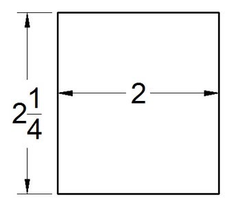

Step 10: Trim to Outside Dimensions
Cut the outside dimensions (2" x 2 1/4").

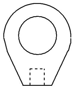

Step 12: Rough Trim to Final Dimensions
Now cut away all the excess. If you have a sanding machine of some kind, leave a little of the outside lines showing to use as a guide while sanding.
Step 13: Sand to Final Dimensions
Sand the wood ring down to the lines drawn. If you don't have a belt sander or disk sander you can cut the edges close with a scroll saw.
