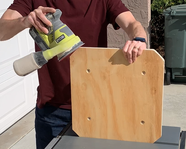

Step 9: Cut Plywood Corners (optional)
- Mark the plywood with a pencil to follow the contour of the cradle corners
- Remove the cradles from the plywood
- On each corner, mark a diagonal line tangent to the curved line
- Cut the corners as marked
- Use sandpaper or a finishing sander to sand the cut corners (and the other sides, if necessary)
- If not painting, reassemble as described in Step 8.
