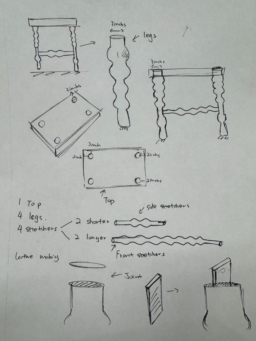

Step 1: Sketches and Concept
The project began with a series of hand sketches exploring the overall proportion, leg profiles, joinery details, and construction method. I focused on creating a balanced visual rhythm by combining flat planes with turned, organic shapes for the legs and stretchers.
During this stage, I considered how each part would be fabricated, joined, and assembled by hand. I explored different lathe turning profiles for the legs, tested dimensions for stability and comfort, and mapped out the position of the stretchers to ensure structural integrity.
This initial drawing process helped clarify the relationship between each component — the top, four legs, and stretchers — and guided my decision-making for both material selection and tool usage later on.

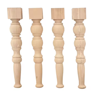

To shape the bench legs, I started by cutting four rectangular hardwood blocks to roughly the same dimensions using a bandsaw. Accuracy at this stage was essential to ensure all legs would look balanced once turned.
Next, I marked the center on each block and drilled guide holes to help mount the wood securely on the lathe. Turning the rough blocks into clean, smooth cylinders required patience and steady handwork — I constantly checked the diameter and shape with calipers and a ruler to keep them consistent.
Once the basic cylinders were formed, I used the lathe again to carefully carve out the final leg profiles based on my sketches. This step taught me how to control the lathe tools, maintain symmetry, and appreciate the craftsmanship behind traditional turning techniques.

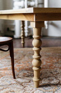

Step 7: Assemble
In the final stage, I carefully assembled all the components to complete the bench structure. I used a Japanese saw to trim off any excess tenons and pegs, ensuring a clean and flush finish at each joint.
To reinforce the connections, I crafted eight small wooden wedges and inserted them into the stretcher joints. This traditional technique helped tighten the joints, adding more stability and durability to the entire piece without the need for metal fasteners.
