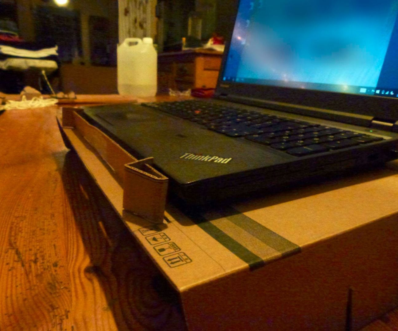

Step 10: Enjoy!
Now you can enjoy whatever you've made!
I hope this tutorial was usefull and that you have made an incredible piece of bent woodwork. Please feel free to comment any improvements or pictures of what you have made.
