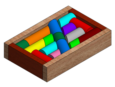

Introduction: Wood Dowel Puzzle
There are eight dowel segments that you must fit into a box. You should be able to get seven pieces in with ease. What about the last piece?

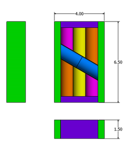

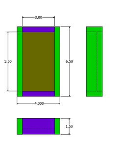

Step 2: Drawing
You will be building to the drawing. Yep, I just gave away the solution.

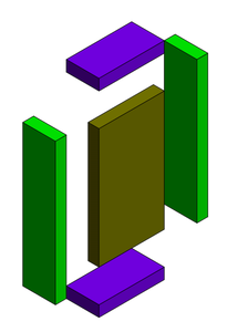

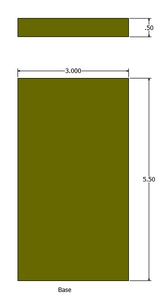

Step 3: Base
Cut wood for the base as shown.

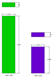

Step 4: Sides
Cut 2 long and 2 short sides as shown.

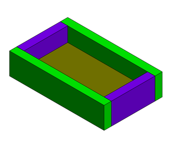

Step 5: Box
Use glue to attach the sides to the base. Apply pressure with wood clamps. Remove excess glue and sand as necessary.

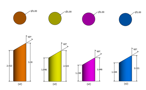

Step 6: Dowel Segments
Set your table, miter or band saw to a 30 degree angle. Cut 1” dowels to the lengths shown.

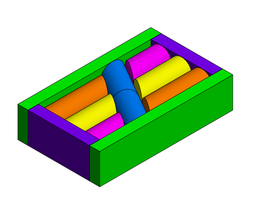

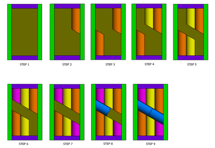

Step 12: Solution in Pictures
If you plan to build this for someone, you might want to print solution instructions to go with the puzzle.

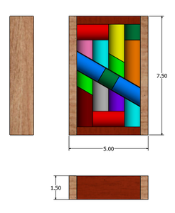

Step 14: Advanced Version
See HERE for advanced version.
