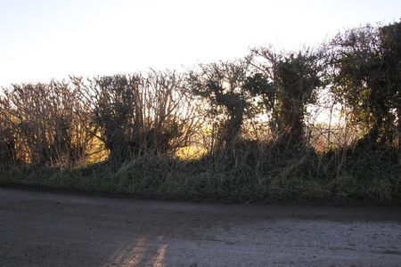

Step 2: The Hedge Before Work Begins
At this stage the hedge is starting to look a bit scruffy, with some of the species such as blackthorn starting to get shaded out by the bigger trees such as ash and oak. John inspects the hedge carefully, making a mental note of the bigger trees for leaving, the intermediate suitable for coppicing and the smaller ones for laying. I think that the dog is looking for a rabbit?
