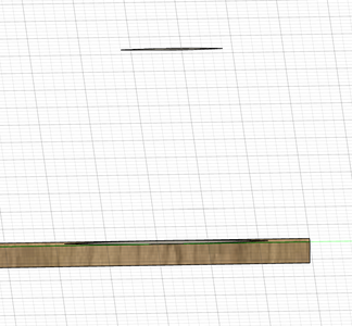

Step 1: Making of Base
  1. Select Sketch and Plane: Open Fusion 360 and choose the "Sketch" feature. Next, select the plane where you want to create your sketch. You mentioned choosing the "right plane," which is a common choice for many designs. This sets the foundation for your 2D sketch.
  2. Draw a Rectangle: Within the sketch environment, use the appropriate tools to draw a rectangle. You can typically find this tool in the "Create" panel. Draw a rectangle by specifying its dimensions, either by clicking and dragging or entering specific values.
  3. Extrude the Rectangle: After creating the rectangle, you can extrude it to the desired thickness. Use the "Extrude" tool, often located in the "Create" or "Modify" panel. Enter the thickness you want, in this case, 10 mm, or any other desired value.

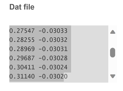

Step 2: DAT File Setup
  1. Visit the Airfoil Tool Website: Go to the Airfoil Tool website (airfoiltools.com). This website provides a database of various airfoil profiles that you can browse and choose from.
  2. Select Your Desired Airfoil: Explore the database to find the best aerodynamic profile that suits your project's requirements. You can search and filter airfoils based on parameters like thickness, camber, and more.
  3. Access the DAT File: Once you've chosen an airfoil profile, locate the DAT file for that specific airfoil. DAT files contain the coordinates of the airfoil's shape.
  4. Copy DAT File to Notepad: Click on the DAT file link to access the data. Select and copy the entire content of the DAT file.
  5. Save as DAT File: Open a text editor like Notepad on your computer. Paste the copied content into a new text document. Initially, you may face issues when saving the file. To resolve this, choose the option to save the file in "All Files" format and add ".dat" to the end of the file name. This ensures that the file is saved in DAT format.

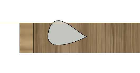

Step 3: Genrate Airfoil Face
  1. Construct a Construction Line:
  2. Within your Fusion 360 design, access the sketch where you have imported the DAT file, which represents your airfoil profile.
  3. To create a construction line, select the "Sketch" menu and choose "Line" or "Polyline." Make sure you enable construction mode for this line. This line will serve as a guide for connecting the last two points of your airfoil.
  4. Add the DAT File Using Add-Ins:
  5. If you haven't already, use Fusion 360's add-ins or tools to import the DAT file that represents your airfoil profile. Ensure that the imported airfoil aligns with the construction line you created in the previous step.
  6. Connect the Last Two Points:
  7. Zoom in on the area where the last two points of the airfoil are not connected. You'll likely see a gap between these points.
  8. To connect them, use the "Line" or "Polyline" tool again, this time without enabling construction mode.
  9. Start the line or polyline from one of the unconnected points and draw it to the other point. This action should close the gap, creating a continuous line.
  10. Generate a Closed Face:
  11. Once you've connected the last two points with the polyline, the airfoil profile should now form a closed shape.
  12. Fusion 360 should automatically recognize this closed shape as a face. If not, you can explicitly use the "Create" menu to generate a face from the closed profile.

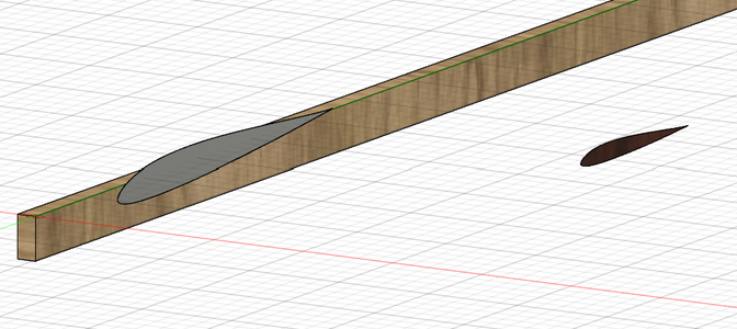

Step 5: Creating Wing
  1. we're looking to create wings for your glider by adjusting the extruded airfoil, making a copy, and scaling it. Here's a step-by-step guide to achieve this in Fusion 360:
  2. Adjust the Extruded Airfoil:
  3. Start by selecting the extruded airfoil that you created in Step 3.
  4. Enter the sketch environment for this face if it's not already in sketch mode.
  5. Make any necessary adjustments to the airfoil shape using the sketch tools. This allows you to modify the shape to your desired aerodynamic profile.
  6. Create a Second Airfoil:
  7. After adjusting the first airfoil to your liking, exit the sketch mode and return to the 3D modeling environment.
  8. Now, use the "Move and Copy" command to duplicate the modified airfoil. Select the airfoil, choose "Modify" from the menu, and then "Move and Copy."
  9. Position the copied airfoil where you want to create the second wing.
  10. Scale the Second Airfoil:
  11. With the second airfoil selected, use the "Scale" command from the "Modify" menu.
  12. Specify the scale factor. In your case, you want to scale it to 0.50, which means 50% of the original size.
  13. Ensure that the scaling is uniform, maintaining proportions, and apply the scale transformation.
  14. Arrange the Airfoils:
  15. Adjust the position and orientation of the scaled airfoil to achieve the desired aerodynamic shape for your glider's wings.
  16. You can use the "Move" and "Rotate" commands from the "Modify" menu to arrange the airfoils precisely as needed.
  17. Review and Refine:
  18. Carefully review the arrangement and positioning of both airfoils to ensure they form the desired wing shape.
  19. Make any further adjustments as necessary to achieve the desired aerodynamic profile.

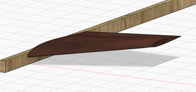

Step 6: Using Loft Command
We will create the wing structure using the "Loft" command in Fusion 360. Here's a more detailed guide on how to do this:
  1. Select Faces:
  2. First, ensure that you have the two faces you want to use for creating the wing structure. These faces can be the extruded airfoil and any other relevant face or profile that will form the wing.
  3. Activate the Loft Command:
  4. In Fusion 360, go to the "Create" menu at the top of the screen.
  5. From the dropdown, select "Loft" under the "Create" section. This will activate the Loft command.
  6. Select Profiles:
  7. With the Loft command activated, you'll be prompted to select profiles or sections. Click on the first face (profile) that you want to use for the loft. Then, select the second face (profile).
  8. Adjust and Preview:
  9. Fusion 360 will automatically create a lofted surface that connects the two selected profiles. You can adjust the loft by manipulating the handles or control points that appear.
  10. Preview the lofted structure and ensure it forms the desired wing shape.
  11. Complete the Loft:
  12. Once you are satisfied with the lofted wing structure, press the "OK" or "Finish" button to complete the loft operation.
  13. Refine and Modify:
  14. After creating the initial loft, you can further refine the wing structure as needed. This may involve adjusting the loft's orientation, size, or any other parameters to achieve the desired aerodynamic shape.
  15. Review and Save:
  16. Carefully review the created wing structure to ensure it meets your design requirements.
  17. Save your work in Fusion 360 to preserve the wing design.

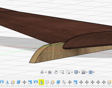

Step 11: Finishing
  1. we will apply fillets to finish the design and achieve the desired look. Fillets are rounded or curved edges that can improve the aerodynamics and aesthetics of your glider. Here's how to do it:
  2. Select the Edges:
  3. Go to the "Modify" menu or the equivalent option in your CAD software.
  4. Choose the "Fillet" command.
  5. Select the Edges to Fillet:
  6. Click on the edges of your glider's wings, body, or any other parts where you want to apply fillets. These edges will become rounded.
  7. Specify the Fillet Radius:
  8. After selecting the edges, you'll be prompted to specify the fillet radius. This determines how large the rounded curve will be. Enter the desired value, or experiment with different sizes to achieve the look you want.
  9. Apply Fillets:
  10. Confirm the fillet radius, and the software will automatically round the selected edges.
your hand glider is ready .
