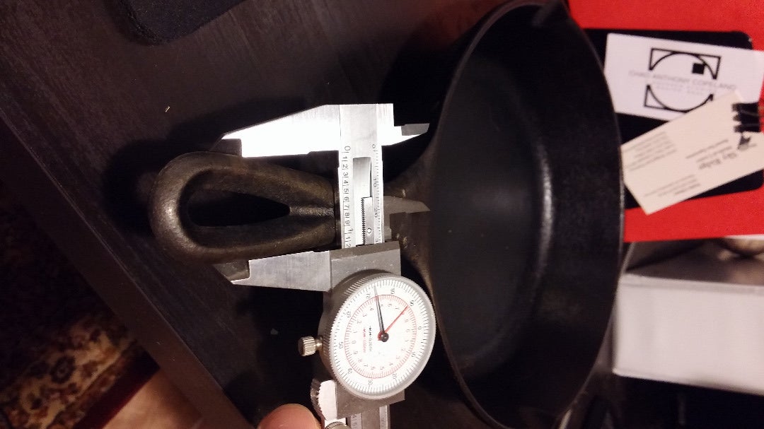

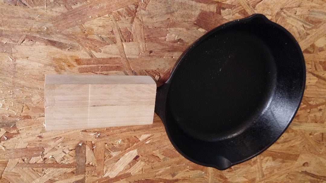

Step 3: Measurements
Take a few measurements of the cast iron handle. A dial caliper works well for this purpose. Each cast iron handle is different, so measuring for each handle is necessary.

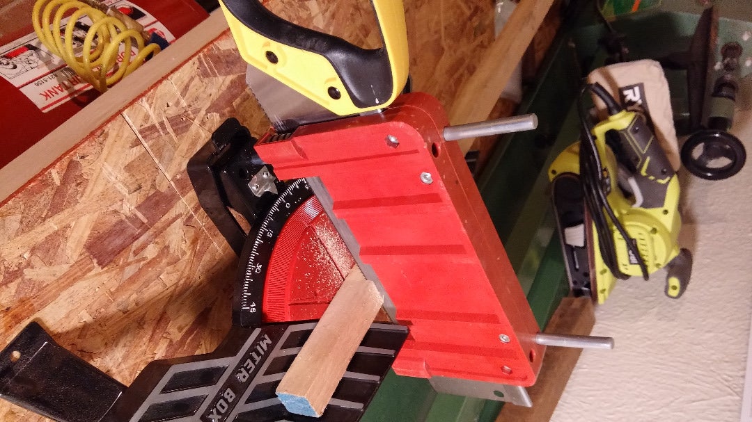

Step 4: Cut the Wood

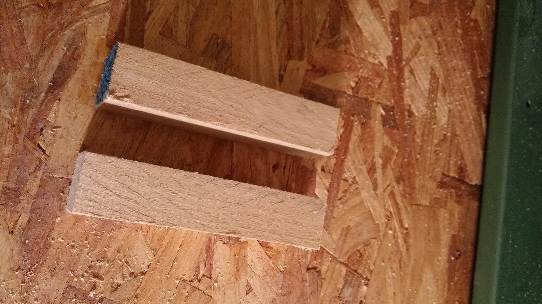

Cut a piece of hard wood large enough to accommodate the handle. I only had narrow pieces, so I cut a few to glue together.

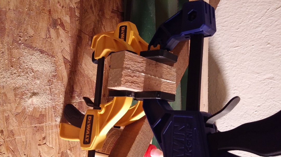

Step 5: Glue
Glue and clamp the pieces together to achieve a size large enough for the handle.

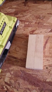

Step 6: Sand
Sand the surfaces of the wood to make an even smooth block.

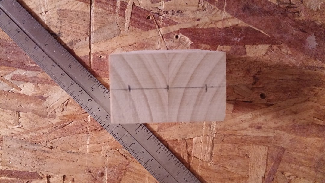

Step 7: Mark the Wood
Mark the wood with the measurements taken with the caliper.

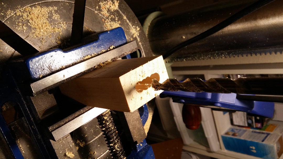

Step 8: Drill
Drill the center of the wood to accommodate the handle of the skillet. I drilled center, left and right before it drilled out the two small remaining bits of wood. I then used a hand drill to manually smooth out the inside of the rough hole.
Step 9: Fit the Handle
I fit the handle to the pan and continued to adjust the hole with a hand drill until the wood fit the skillet handle snugly.

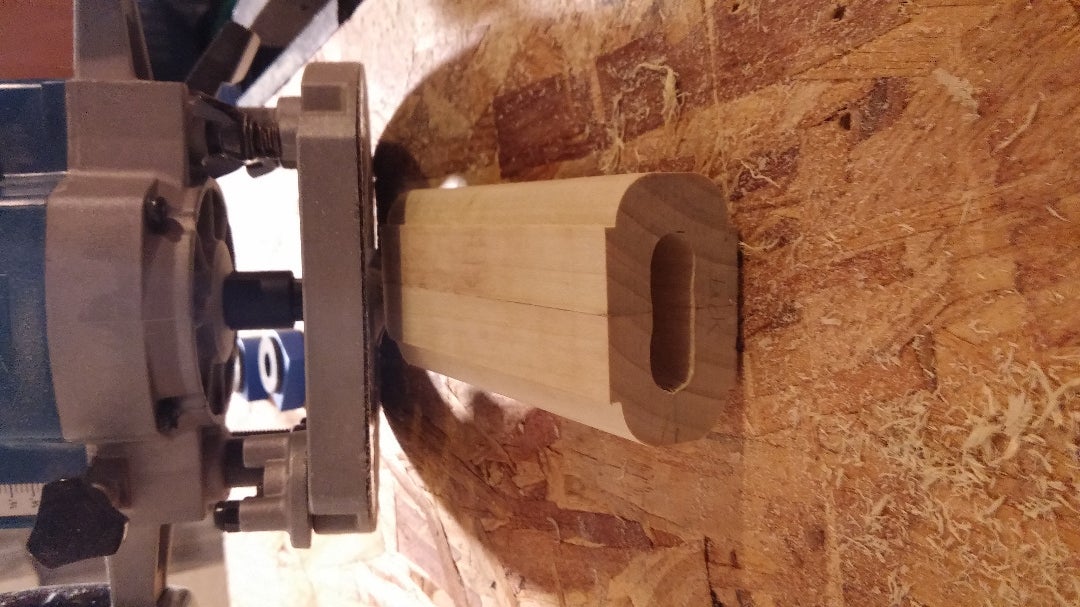

Step 10: Router
Use a router to round out the edges of the handle.

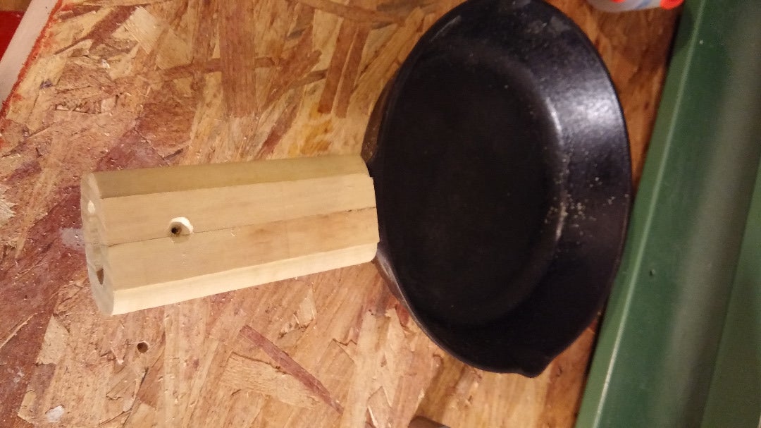

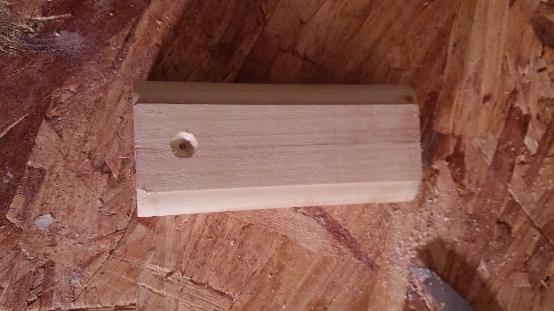

Step 11: Drill Pilot Hole
Use a caliper to measure between the pan side of the wood handle and the back of the hook hole in the skillet handle. Drill a pilot hole here. Also countersink the hole to accommodate a screw head.

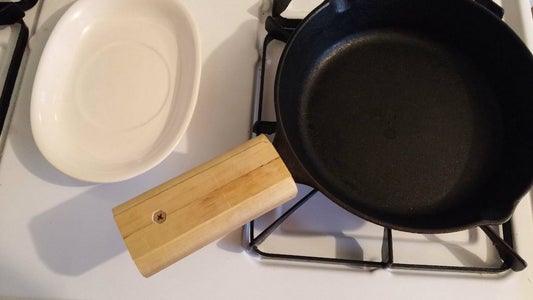

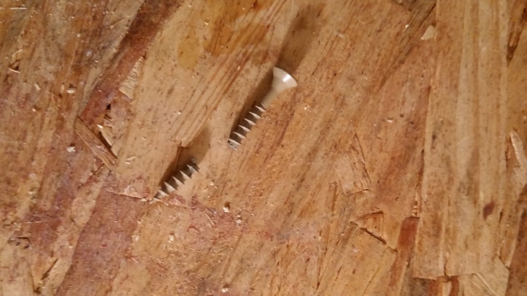

Step 12: Screw Handle
Add a screw to the hole to fasten the handle in place. Cut a screw to the right length if necessary. Originally the handle was snug enough that it didn't need a screw, but after a little use it began to loosen up and I decided to add a screw.The screw will heat up, so a grip avoiding it is necessary.
