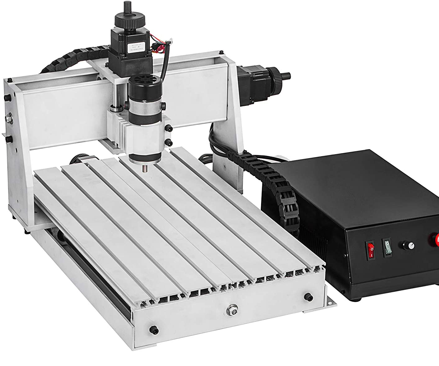

A CNC ...

  1. I'll be maching that in a piece of oak. Let's say hard wood
  2. I'll be using 1/8 inch flat end mill of basic quality with 2 flutes
  3. spindle rotation speed on my CNC is limited to 8000 rpm
  4. feed rate on my CNC is limited to 2500 mm/minute

So in the end here are the parameters :
  • hard wood (oak, will be the same sor Azobe in the next setup)
  • 1/8 end mill
  • maximum spindle speed of 8000 rpm
  • chipload 0.004
  • feed rate 1500 mm/seconds
  • passes of maximum 1mm
Note that with better CNC and tool I'd double spindle speed, feed rate and pass depth so machining time would be divided by 4.
Also note that shipload is really low for small diameter tools like this. Every time it's possible I use 6 mm mills that allow me tu use max feed rate and are confortable with passes of 1.5mm. less risk to break the tool and machining twice faster. Again with a faster and more powerful spindle and a CNC that support faster feed rates I coud improve machinig time by a factor of minimum 4.
Conclusion : if you don't have the budget for a professional CNC, machining takes (much) more time.

Step 7: Produce !
You've got your GCode ready.
Fasten your first stock on the bed of the CNC.
Check axis screw are fastend and tight
install the tool
if your machine does not have limit switches set home position well above with G28.1
Set zero on the top center of your stock and run.
Repeat for the other setup.
