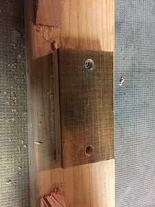

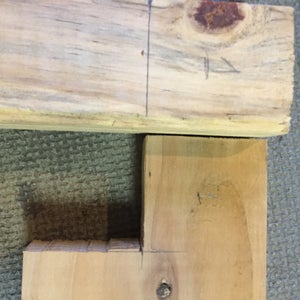

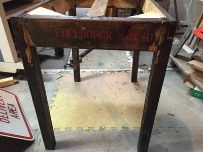

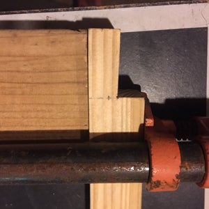

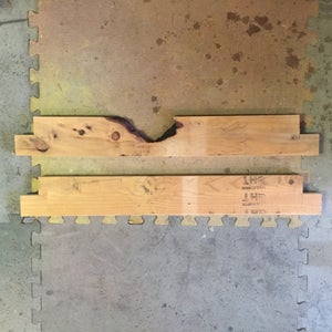

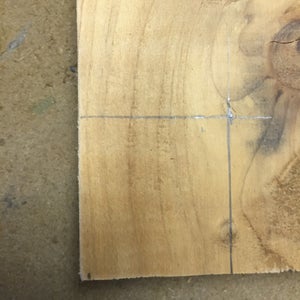

Once I decided on the size of my table, I chose which pallet boards to use on the sides and legs and began marking where I needed to cut. I never drew out any blueprints for my design, but I chose to have the screws in the corners hidden and this shows how I accomplished that. In retrospect, this resulted in a table that stays together, but isn't really solid like I wanted. So what I would suggest is following the same type of cuts, but in the end using a lag bolt in each corner to keep everything together. Anyway, as you can see, I cut out a bit of the corners of the length side boards to allow them to fit flush with the legs, which have a similar cut. The leg boards are made from a 2"x4" cut in half. In actuality, a 2"x4" board really isn't 2" by 4" so my table legs are more like 1.5"x1.5".

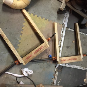

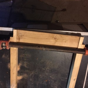

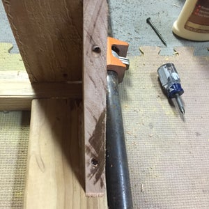

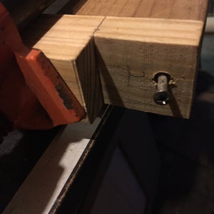

Once length side boards and legs fit together, I measured out the boards for the width side, which are made from a 2"x4." With my goal of my table being 18" wide, I took the total width of both table legs and subtracted it from 18" which gave me the length I needed for my width side board. Once my width side boards were cut, I lined up the board with my table legs, leaving the side of the leg with the wood removed on the outside. Next, I added wood glue (using a thick epoxy instead would be better because the glue dripped out and prevented the stain from coloring the wood) and clamped them together. After the clamp was secure I added drilled a hole and put in one wood screw to hold it together (cover the threads of the screw with bar soap to help them go in easier). Finally, I let the glue dry before continuing.

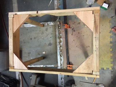

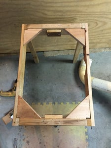

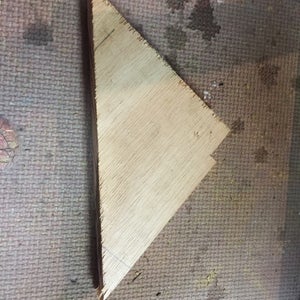

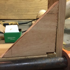

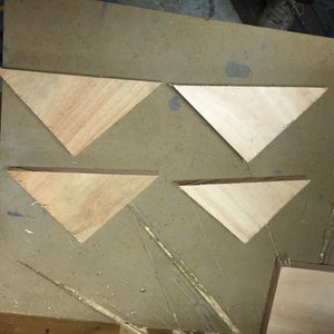

Because I did not want any screws visible, I used boards cut at 90° to hold the length side boards to the width side boards. I used a pencil to mark where my drill holes would go for my screws, then put it together with the help of the clamps.

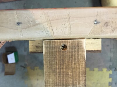

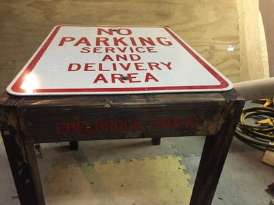

To add the table top, I attached two small pieces of wood to the inside of the width side board with screws, then used a piece of wood which was long enough to span between the two pieces and used a screw to hold it in place. Finally, I lined up my sign to the frame and marked where the bolts would go through to fasten the sign to the board and drilled the holes. Finally, I used a walnut stain on the frame and secured the sign to the spanning board with the original bolts.
