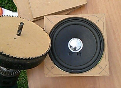

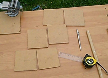

Step 2: Cutting MDF
You need to cut from MDF:
  • 2x 125mm x 125mm (UP/DOWN)
  • 2x 125mm x 113mm (SIDES)
  • 2x 113mm x 113mm (FRONT/BACK)
In one 113 x 113 you need to drill a hole for a speaker and in one SIDE plate you need to cut smaller hole (about 25mm).
Using sandpaper you can smooth holes and edges.

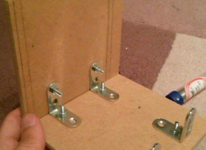

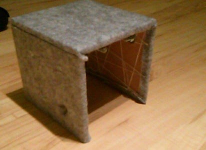

Before connecting wood parts ( screws , brackets , nuts) you need to fix felt to the walls . I sewed them , you can use glue or stapler.
For better sound you could put inside wadding :)

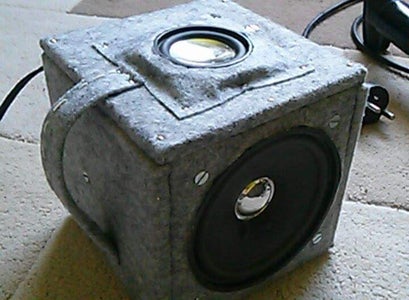

Step 5: Improved Version
This version has a handle and high frequency speaker on the top (connected parallel to the main speaker).
