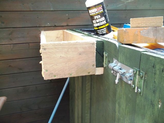

Here are a couple of photos to show the difference between the treated and untreated reclaimed pallet timbers.
On the left is untreated Hive number 19 (populated) and on the right is treated Hive Number 20 (currently vacant). Sometime during this week I'll swap the colony over from 19 to 20, and then I'll have the opportunity to treat number 19 with a coat of plain Linseed oil, and then a then a coat of blended Linseed & Beeswax....... hopefully before another swarm becomes available.
