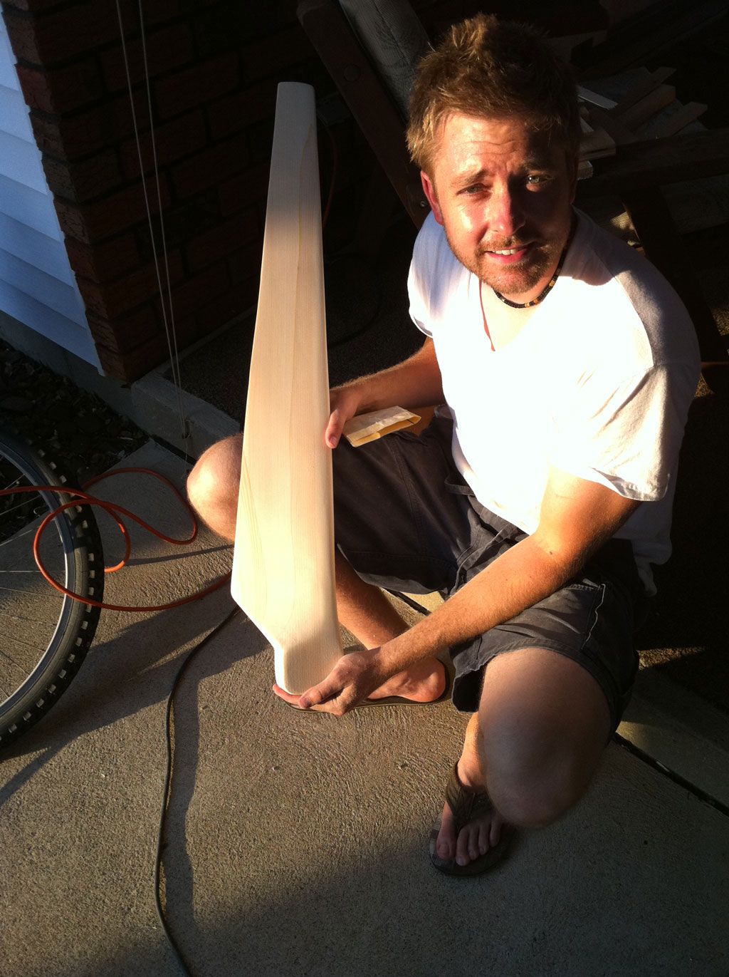

This tutorial will show the steps needed for anyone to carve a propeller out of wood.

Step 4: Cut the Propeller Profile
By marking the profile of the propeller (looking down on the wood) you can use a hand saw to cut out the profile of the propeller, this will save you time when you go to 'hog out material'
Step 5: Begin Hogging Out Material
Now this is the most time consuming part, you will use a chisle or draw knife, or any cutting tool to start widdling away wood material until you can start fitting on you templates to see where material needs to be taken out.
Step 6: The Fun Part Is When You Get Down to the Templates
Once you have hogged out most of the unwanted wood, you can now use the templets and hold them up to the correct stations along the blade to see where material needs to be removed. Be careful not to remove too much, you can't put it back once its gone. The hardest part will be the root area, were the templates are hard to align. Marking the front and back of the propeller with a small notch will help align the templates.
Step 7: Final Step Is to Sand and Add Stain
You can use sand paper to sand down and smooth out the contour. Be sure to start will rought paper 40 grit to 100 grit, and work you want down to a nice 600 grit or finer. Then you will apply some water proof finish. If it is an outdoor propeller you will need to use a thick water proof varnish. This propeller is for an airboat (http://www.aerodyndesign.com/FAN_BOAT/FAN_BOAT.htm)
