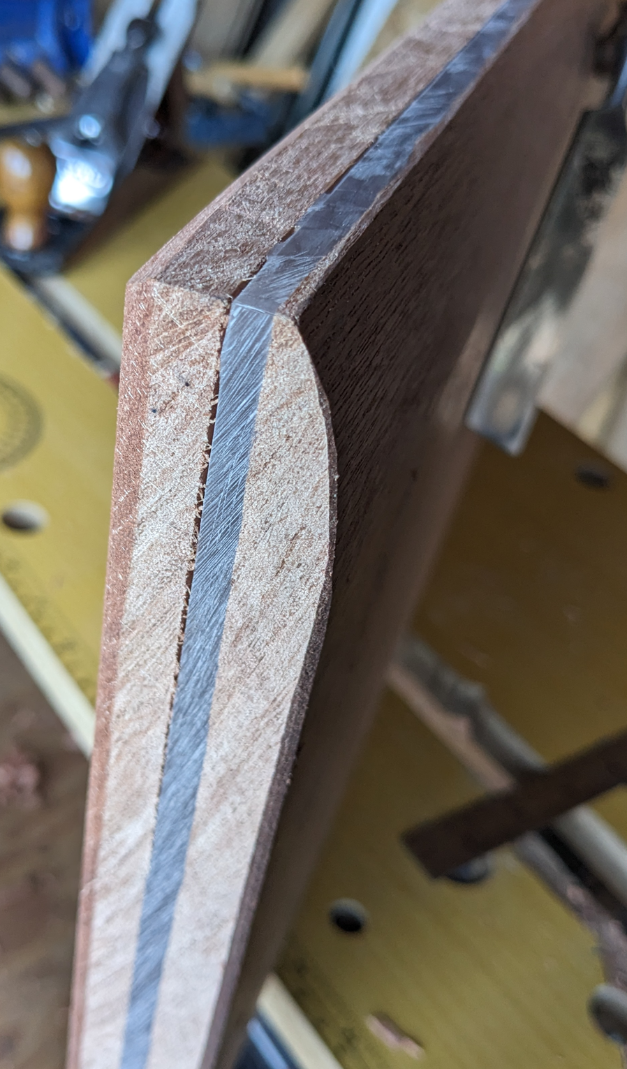

After the resin has fully cured, you’re now ready to trim down the combined board to size. I would recommend cutting it to your final size + a few mm.
For mine, I trimmed to 265mm x 605 mm. This will allow you to make a quick rough cut with the jigsaw then neaten it up with a hand plane or sandpaper. If you used a mould for Step 2, or planed everything to the same height, you won't have the issue I had which was gaps between the top board and the resin.
Note – hand planes are suitable for cutting resin, but you will need to ensure the plane is very sharp and adjusted to take a very thin shaving (otherwise the resin will chip out)
I also took this time to use the hand plane to soften the edges. As the boards are quite thick, a large, shallow bevel gives the illusion (from the front) of a much thinner board. I also added some chamfers to the side corners. Nothing was measured here, but I went very slowly with each shaving to remove as little material as possible whilst achieving the look I wanted.

  • Gap between resin and wood in final cut
  • Root cause – Board was not completely flat when doing the first resin pour.
  • Remedy – Fill in the gaps with partially set resin at the end. I let my resin (usually 36 hours to full cure) cure for 12 hours before using it to fill in the gaps. You’ll see that it was still a little fluid and didn’t make an even layer.
  • How to avoid – Make use of a mould when pouring the resin. This will allow you to overfill the resin layer and sand/plane it down to a perfectly flat, full and even layer. Cam from Blacktail Studio (on Youtube) has some great videos on how he builds his moulds when building his resin tables.
