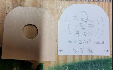

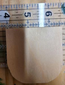

Step 1: Cut the Blanks
You need two 2.5" square pieces - I used luan for my prototype...
Step 2: Cut the Center Hole
Use the 3/4" forstner bit
  1. Cut out in each piece (double them up, if possible)
  2. watch for blowout on the back

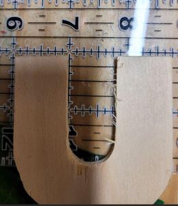

Step 3: Cut the Notches
Using the Band saw, cut out the notch to match the dimensions of the 3/4" hole
  1. Do this in each..
  2. Cut from the non-rounded-end side of the blank... ;-)

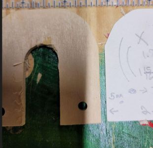

Step 4: Drill the String Holes
Drill the 5mm holes in each 'end'
  1. 4, in total, or double up the blanks...
  2. again, watch for blowout on the back

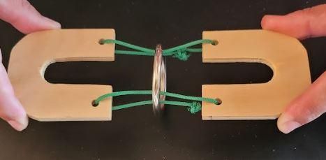

Step 6: Tie the Strings
Connect the ends with string, and use a cigarette lighter to 'lock it in'...
Step 7: Enjoy the Game
