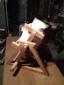

This is an old project I made, before my instructable days. As such, I didn't take detailed pictures. However, it was a fun little project and worked relatively well. I gathered a bunch of scrap wood in my workshop, and arranged them into a holder that could spin a protein container. I tried to draw out the steps of the project. I hope it is reproducible this way. Good Luck.

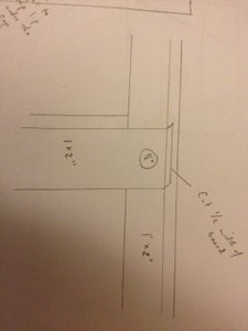

Step 2: Connecting the Wood for the Frame
As in the diagram, I used a dado blade on my table saw to cut throw 1/2 the width of each piece of wood where they connect. I pressed them together with glue, and clamped them until dry. I then drilled a 1/2 inch hole into the place where the wood is glue and glued in a 1/2 inch dowel (cut to be flush on both sides) into the hole.

Step 3: Assemble the Body of the Washing Machine Around the Container
Once both sides were completed, I cut 1/4 inch dowel to run from each side and connected them around the container (gluing each dowel in).

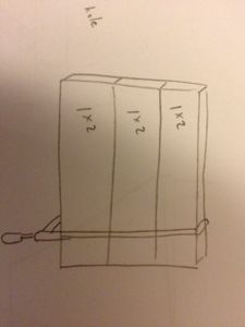

Step 4: Starting the Legs
I took three pieces of 1 by 2 inch pine and glued them together (clamped along the wood). I made two of these, 6 inches wide at the widest.

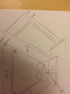

Step 5: Framing the Legs
While the other sections were drying, I took 6 one and a half foot sections of scrap 1 by 2 pine and made two equilateral triangles out of them. I connected the bottom boards with wood screws and glue as shown in the pictures. I then cut out the top section of each side of the triangles. I did not measure these cuts, I tried to visualize it so that they were even.

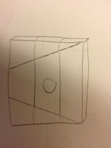

Step 6: Draw Your Cut Lines Onto the Glued Square
Place the triangle over the glued square from before and use it to draw the cut lines for the square. I then cut the excess off of the square, and then drilled a 1/2 inch hole into the center of what remained.

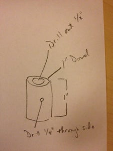

Step 9: Capping the Dowel
Next I took a section of 1 inch dowel and drilled out a 1/2 inch hole through it lengthwise. I slid this piece over the end of the 1/2 inch dowel protruding from the side of the foot. I then drilled a 1/4 inch hole through the side of both dowels, and slipped in a 1 inch section of 1/4 inch dowel. this capped the end of the dowel, allowing it to turn in the wood of the foot, without slipping off the end.

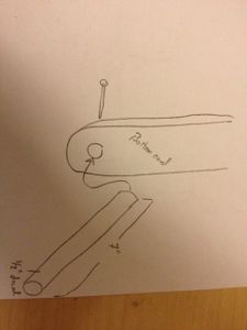

Step 10: Making the Handle
On the other side (the other foot), I made a handle to turn the body. I took a 9 inch section of 1 by 2 inch pine, rounded the edges with a belt sander, and drilled a 1/2 inch hole at each end. For the end of this crank section that connected to the foot (the top in the drawing), I cut a 2 and 1/2 inch section of 1/2 inch dowel (note the size is wrong in the drawing-it is not 1 and 3/4 inches) and pushed it through the top of the handle, the top of the foot, and the side of the body. It should be flush to the inside of the body (where the container is), and outside the handle. Use a finishing nail through the side of the top of the handle to keep the dowel from spinning in the handle. Also put a finishing nail through the side of the body wood (where the container is) to keep if from spinning. Do not put a nail into the foot-the dowel should spin in the foot. Note: if the dowel is tight in the foot (or any place it should spin freely), sand out some of the hole to allow freer spinning.
Step 11: Bottom of the Handle
For the actual handle to the crank, I cut a 7 inch section of 1/2 inch dowel. I pressed it into the bottom of the crank until flush with the back of the crank. I then pushed a finishing nail through to keep if from turning.

Lastly, I cut two pieces of wood to run from the front and back of each foot to the other foot. I measured this after things were assembled to ensure proper fit. I glued these sections on, and screwed two wood screws into the ends as in the pictures.
Step 15: Usage
To use the device, you add boiling water to the jug with a few pieces of clothing and some soap. Spin it for a few minutes then pour out the water. Add water to rinse a few times and spin it again.
