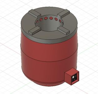

Step 8: 3d Model
Here is the proposed 3d model of the stove you can view it from different angles to get a proper understanding.
