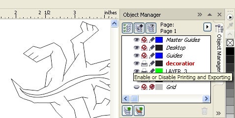

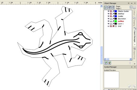

Step 2: Differentiate Between Edge (cuts) and Interior (decoration)
In this step, we need to let the laser know which lines will be vector cut, and which lines are just for decoration (rasterized). To do this, we must ungroup, differentiate edges from decoration by using layers.

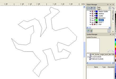

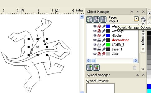

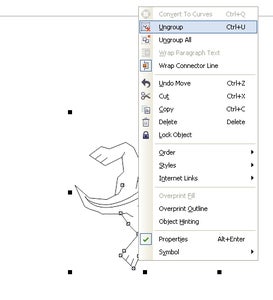

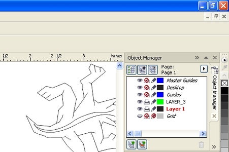

- Image 1: Zoom in. Click on the reptile. Right-click and choose ungroup.
- Image 2: Open the object manager
- Open the Object Manager. If the tab is not already there, choose: Window->Dockers->ObjectManager
- This should give you something like that seen in the 2nd image.

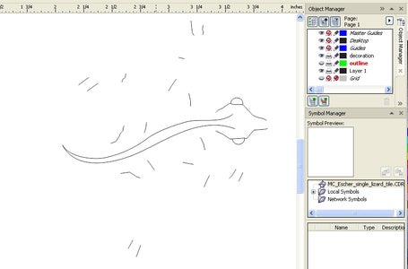

- Image 3: Create a new layer, and call it 'decoration'. Do this by clicking on the 'new layer' button in the object manager. rename the layer to 'decoration'
- Notice the eyeball (visibility) button, and the printer button. We'll be making use of these. The eyeball turns visibility on and off for that layer, and the printer turns on and off the ability for that layer to print. that way we can decide which layers go to the printer when.
- Image 4: Move all decoration to the 'decoration layer'. Turn off visibility of the decoration layer first. Then shift-select and/or area-select the interior decoration of the reptile. Then choosing the Object Manager Options button, and Move To Layer. Choose the 'decoration layer'. Don't try to do it all at once. Move just a few lines at a time.
- Image 5: Once you have all the decoration moved to the decoration layer, you should have just an outline of the reptile. (notice in the process, I also renamed the default LAYER_3 to 'outline' to make things easier.
- Image 6: To see what's what, turn off the 'outline' layer, and turn on 'decoration' layer.

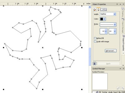

- Image 1: Make just 'outline' visible
- Select all (Ctrl-A)
- Go to Object Properties (Alt-Enter).
- Set Fill Type to 'No Fill'
- Set Width to 'Hairline'
- Go to menu item Arrange->Join Curves, and/or select the join curves tab. Hit Apply to join the outline into 1 continuous object.

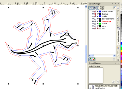

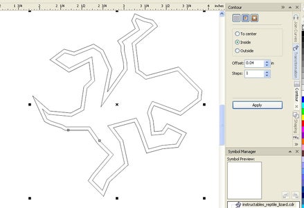

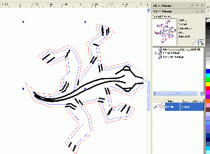

Step 4: Create an Outline-offset That Will Create the Spaces Between the Reptiles.
In this step, we will shrink the reptile with an offset so that veneer will appear BETWEEN reptiles. This gives an awesome look to the finished product.
- Make just the outline visible (hide the decoration layer)
- Select your outline object (should be 1 single joined path if the 'Join Curves' worked previously).
- Open the Contour tool: Window->Dockers->Contour
- Choose 'Contour Steps' button, select 'inside', offset=0.05 in, steps=1 and apply.
- If it looks good, great. If not, undo and try again with a different offset. until it looks about right.
- Once you like the looks, right click on the INNER LINE of the reptile and choose 'Break Contour group apart' from the context menu. Now you have 2 separate vectors that can be independently manipulated.

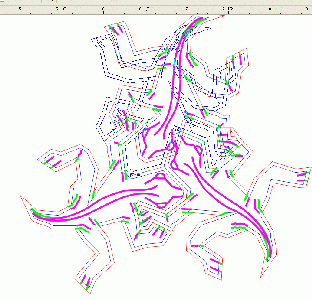

Step 5: Fix Your Decoration to Fit the New Outline
Make your decoration visible. You can see that the decoration now overlaps your inner blue line. You don't want that. You want it to just touch the line. This is an optional step: if you don't want decoration on your final result, you can skip this step.
This really just consists of tweaking each bit of decoration until you get something you like. You may also want to preserve the original decoration, so I suggest copying the 'decoration' layer to a 'decoration-remix' layer and modifying just that one.
Now you should have 2 decoration layers, the original, and the remix version. The remix version is the one we will use for engraving later.

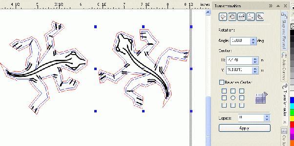

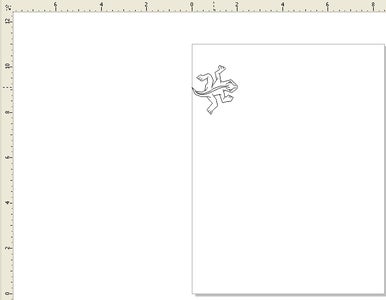

Step 7: Instantiate a Bunch of These Little Guys
Now that we have our handy dandy new symbol, we can instantiate a bunch of reptiles. To do this, you'll need to stamp out a few and do precision rotation on them.
This gives you the basis for creating your tiling. The trick to precision placement to to be in the 'Pick tool', and choose a nodeon the red reptile (say the nose node), and line it up with the corresponding node on the next reptile. Corel is quite nice and it will auto-snap to the right place. (see last image on this step).
Okay, so about now is when I realize that my layer assignments didn't make it into the symbol. All items in the symbol are on the 'outline' layer. This isn't the end of the world. Now we learn to edit symbols. Right-click on a reptile and choose, "Edit Symbol". This gives you just a single reptile

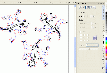

- Copy paste to create 2nd instance of the reptile.
- Choose reptile #2 and go to transformations (Window->Dockers->Transformations->Rotate)
- Click on the rotate button if necessary
- Make Angle=120 degrees and press 'apply'

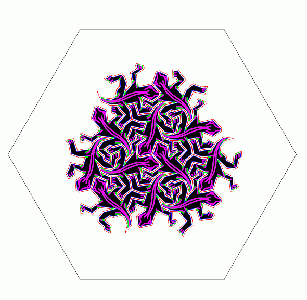

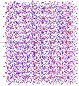

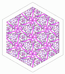

Step 8: Create a Large Tiling
Now, tile your little guys all over creation to make a nice surface tiling. Just copy, paste and align a bunch of times. Careful not to overlap any reptiles because that will create double vector cuts along the same line -- a bad thing.
For your convenience, this file is attached on this step as, "reptiles-array.cdr".

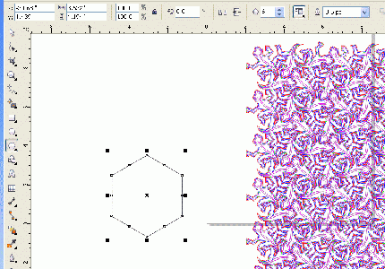

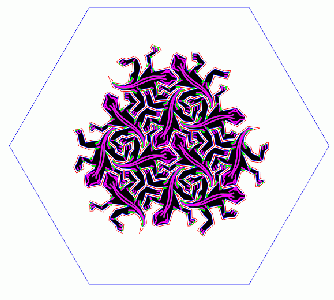

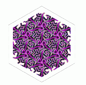

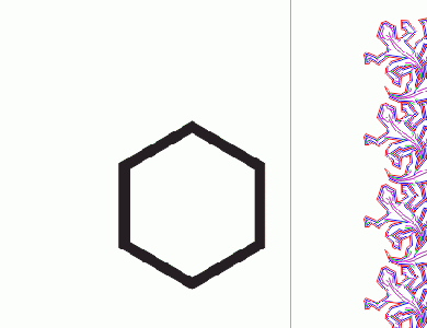

Step 9: Create Your Hexagon Outline for Trimming.
Once you're happy with your reptile array, you should save off your last step, or create a separate layer, or do whatever to preserve your work so far. We're about to destroy it all to create a flattened image. Did I mention, save your work so far? Into a different file name....
Anyway, here we go, we're going to create an object, then cut the reptiles around it.
- Choose the Polygon tool, (Y),
- Draw yourself a polygon with the CTRL key held down (makes all sides equal).
- Choose 6 sides in the toolbar for a hexagon
- Set the size to the size of object you like.
- Create a 2nd hexagon, concentric with the first, but smaller.
- Select both hexagons and select Arrange->Combine.
- Choose Object->Properties and set fill to solid black.

Step 11: Trimming Style B: the Easy Way, and Will Still Look Good
The easy way is to simply place as many whole reptile shapes into the hexagon as you can, rather than the whole flatten-and-trim business. This will be quite fast and easy, but will definitely give a different look.
- Ignore the flatten reptiles step. Or just go back to before your flattened the reptiles.
- Place the hexagon on your reptile array.
- Delete any reptiles that are touched by your hexagon.

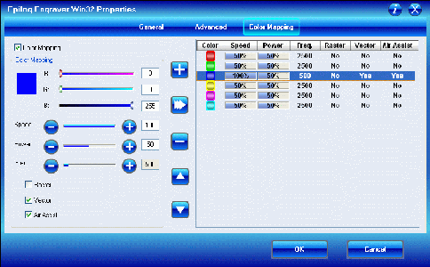

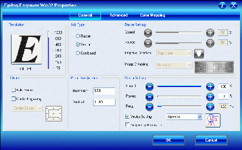

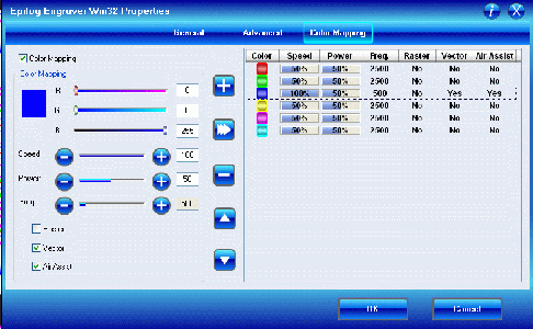

Step 13: Set Up Your Printer Driver.
Now, we're only VECTOR CUTTING now, and only on the BLUE lines. So we need to set up the printer driver to do that.
We'll use the Color Mapping tab so that we ONLY cut the BLUE lines. Configure the printer driver according to the two images below.
Note: On the Color Mapping page, be sure to set all colors but blue to NO RASTER and NO VECTOR. That's so we can simply ignore all the other colors.
Later on, if you'd like to raster your images onto your completed object, you can do that with the Color Mapping tab too. Just pick the right colors and raster settings.

Step 15: Vector Cut. Don't Raster.
Note: if you have skipped here from an early step, and you don't want to do your own artwork, just download one of the .cdr files attached here. Also, go back and check step 13 to understand the printer driver. 'reptiles coaster construction.cdr' is the actual file I used. The other .cdr's were developed just as an example for this instructable, but are still totally usable.
In this step we will vector cut only. In the photos, I did both vector and rastering. This is a BIG MISTAKE. This created zillions of little pieces of tape that are a huge headache to remove later. If you're going to want to raster, do this AFTER ASSEMBLY and SANDING!
For vector cutting the veneer the goal was to not burn the veneer. To that end, I did low power, fast cutting, and multiple passes with the vector cutting. For this step, you need to make sure that only the BLUE lines are going to be printed. You do this in the 'Color Mapping' tab of the Epilog printer dialog as shown in step 13.
Turn off all raster and vector cutting in every color but blue. Make the dialog look like the one attached. i.e. make sure RASTER and VECTOR are turned OFF for everything except BLUE. On Blue, set speed to 100%, power to 50%, air assist on, vector on, raster off. This is how the color coding comes back to help us.
And... focus the laser and hit print! Definitely run this on a piece of paper before you run on your veneer :-)
DO use blue tape to pick the pieces up off the laser.
