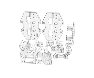

In the picture are the plywood parts, you need the DXF file to cut them with a laser cutter.
Glue parts 1 and 2, 3 and 4, and 5 6 7 and 8 9 10, together these are made from 6 mm plywood. When you are ready you have a bottom part, 2 sides and the middle part for your heated bed.
Glue the sides to the bottom part, see picture 3
Now you need the 3D printed parts from the STL file. Screw the parts on the base see picture 4.
These steps complete your bottom part

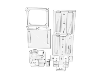

If you like to make this printer you need open the STL files.
Besides that you need to buy some extra parts like the connectors from the threaded rods to the stepper motors and the belt gears. I replaced all those printed parts with metal parts to make the printer more precise.
