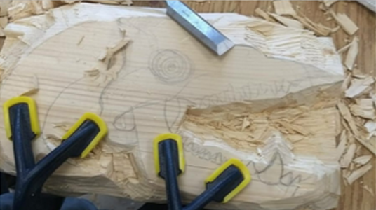

Step 2: Carving Out Big Areas
Before I start discussing my process, I would like to be very clear about one thing: we're working with very sharp knives! Safety is no joke when it comes to a hobby like this, especially at a step like this when we're focused on carving away large areas of wood. So, please, observe caution, never cut towards yourself - always away, and wear cut-resistant gloves if you've got them. Doing that ensures you'll get to keep all your extremities for further woodcarving adventures. With that being said, here's step 2!
As stated above, this step involves subtracting large areas of wood to get a better sense of the rough shape you want. This is your last chance to make any big changes to your plans, because past this point you're pretty much married to the general shape that step 2 brings. Your goal is to chisel away at your piece of wood without focusing too much on the details, as you'll have time to figure those out later. You'll want to keep on chiselling away until you have a rough outline of your desired shape. Don't compromise your original sketch too much. If you do happen to lose some of your sketch as you subtract material, no worries! Just redraw what you lost and keep going until you're happy with your shape and you feel like you can start using finer tools.
The reason we don't just go ahead and start doing this task with our handy general purpose carver is because it'll take A LOT of swipe throughs and elbow grease to remove a large amount of material like this. You'll be left with a knife you'll have sharpened 20 times before the job is complete. It's not that you can't do it - nothing is that strict in woodworking - it's just there are better tools for the job, so why not use those instead and save yourself the trouble? Once you achieve a nice outline you're confident with, you can proceed to step 3!

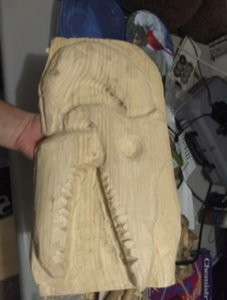

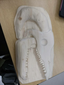

This is the most time consuming step of the entire process, and for good reason! This is the point where your weird little sort-of-carving takes true form under your expert craftsmanship. You'll be alternating from using your general purpose knife, to your tiny baby detail knife, to your spoon carving knife, to sanding paper, and back again to your general purpose knife. It'll seem like this step is consuming the entirety of your waking days, you'll be doing a task unrelated to woodworking and find yourself feeling uncomfortably light without your knives in hand and an ache in your neck from craning in far too closely. Your family will later divulge that you've been madly whittling nothing in your sleep with an imaginary blade, far too familiar now with the motions as you are. You may awaken in the middle of the night, suffering from insomnia and anxious to get back to your woodworking. Let me assure you that this is all completely normal, for the most part. All great hobbies come at a cost, after all.
Regardless of how step 3 manifests in your life, you'll most definitely enjoy this step the most! Make sure to take it slow and consider big actions several times before committing. Remember: it's easy to subtract material, but not so easy to add new material. Keep your knives sharp during this process (I'll generally need to sharpen my knives every half hour of work), and be cautious around areas where the wood grain is working against you. The only part of this piece that'll need the spoon carving tool is the eye socket. It may seem insignificant, but it makes a huge difference in the final appearance of the piece and it's not a feature I would recommend any other tool but the spoon carver for. This is the most natural tool for the job, albeit a bit of an annoyance to sharpen. Regardless, with all things, take it slow and watch a couple of videos on how to use your whetstone to sharpen different wood carving tools at your leisure.
At the end of the process, when you're truly satisfied with your work, you'll want to go over it several times with sandpaper until the surface is smooth, making sure to get into those tough-to-reach places in the mouth and near the jaw. I recommend starting off with a rough grit, then medium, then fine. Next up, we finish the piece!

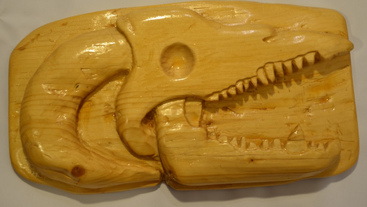

Step 4: Finish Him!
For the finish, I used glossy wood lacquer, but you can use whatever you'd like to finish your piece including natural oils or clear paint sprays. Follow the instructions on the product of your choice, and observe the proper ventilation processes for your respective finish. The lacquer I used was slightly toxic to breathe, so I ensured I wore an N95 mask in addition to working outdoors to decrease my risk of exposure to harmful airborne chemicals in the lacquer I was using. I left my piece to cure, and when it was done I noticed it took on a lovely orange tint that complements the design nicely.
It makes an excellent addition to my wall of memories and knickknacks! The teeth are great for holding Polaroid pictures hostage :)
