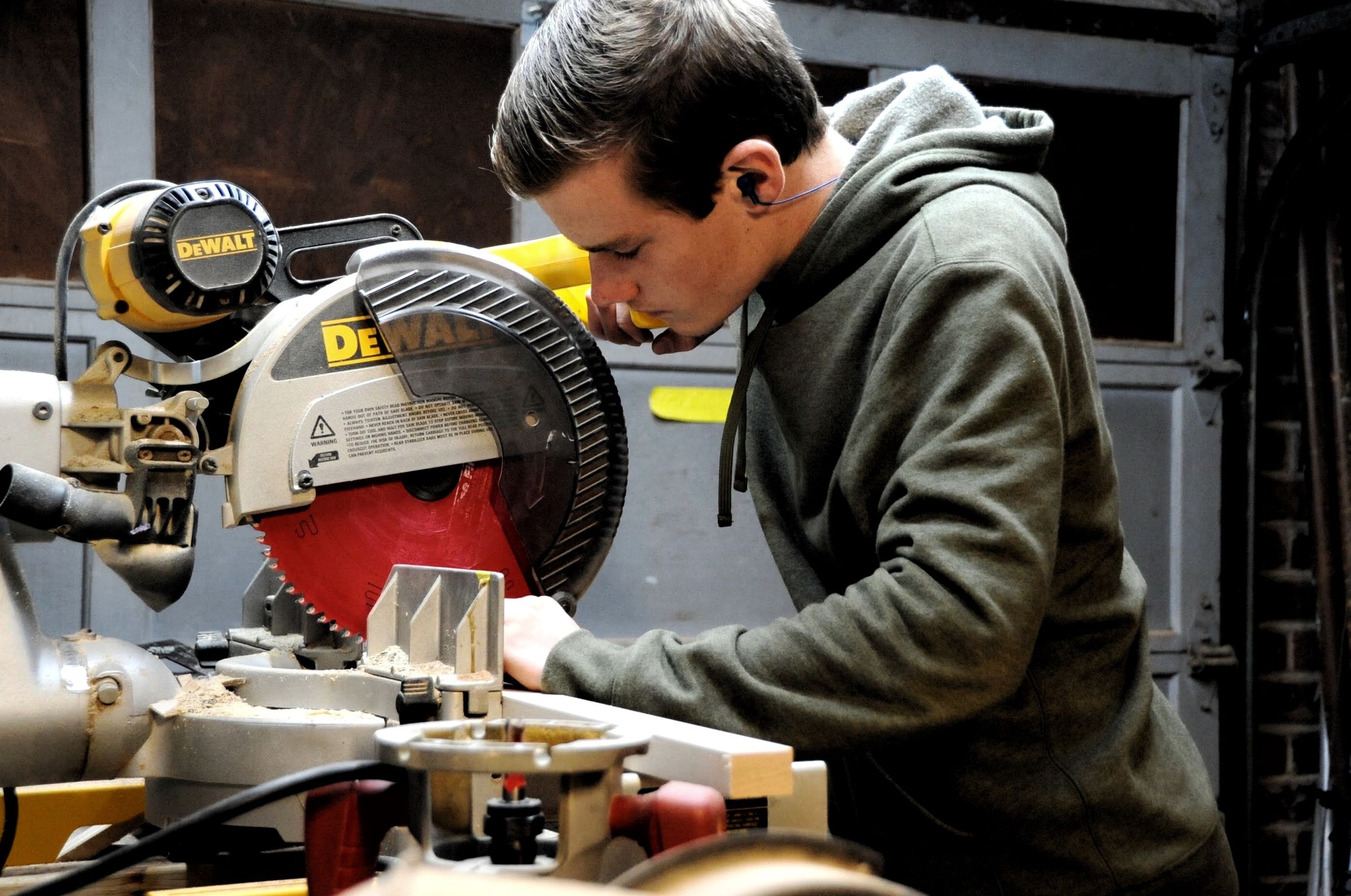

Step 2: Rip and Cut Stripes for Length
Step one: (If you bought precut 1 1/2" material, skip this step). Rip your material down to 1 1/2 inches. Set the fence of your table saw for a 1 1/2" rip and run all your pieces through it. Rip all your material at the same time if possible, without moving the fence, so that all your strips will be exactly the same width.
Step two: Cut your stripes for approximate length. Using a miter saw, cut your pieces down to the lengths you'll need, leaving each one about an inch long- cut 4 pieces of cherry and 3 pieces of maple 24", and cut 3 pieces of cherry and 3 pieces of maple 39". This will allow you to trim your glue-ups to size later instead of struggling to match the ends of your stripes perfectly when you glue them.
