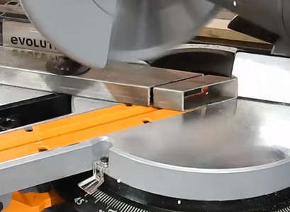

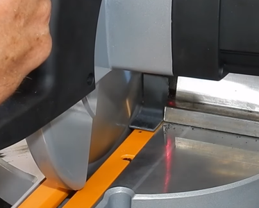

This project requires three 45° angle slices of 1" x 2" tubing. The fact of the matter is you can use any size tubing that is available. 1" x 2" just seemed to be a good size for this use.
The length is up to you, but I used two strips 1½" long and one 1¾" long. These lengths are to accommodate the 1½" angle and the 1¾" coupler nut that will be welded onto the top.
Also cut two slices of angle iron slightly wider that the rectangle tubing you're using. This gives you a little shelf for your weld. At some point, drill a hole into the clamping face of these angle iron pieces because we'll use a small screw to hold a wooden soft jaw onto the clamp face.
Cut two pieces of key stock. One to fit inside the narrow dimension of the rectangle tubing, and one the same length as the coupler nut.
Finally, cut the head off the carriage bolt. These are all the easy cuts. There is only one complex piece in this project and we'll deal with that next.

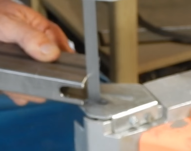

Begin by inscribing a line 1⅛" from the end of your rectangle tube. measure from that line 7/16" toward the end of the tube and center punch for a hole to be drilled. Drill a pilot hole, then a ½" hole.
Cut from the end of the tube two straight lines to intersect with the edges of this hole to form a "U" shaped slot in the narrow edge of the tube. Finally, cut at the inscribed line, then take a ¼" slice to free the part from the tube.
Remove all the burrs and round over the bottom corner to mate with the rounded inside corner of the angle iron.
