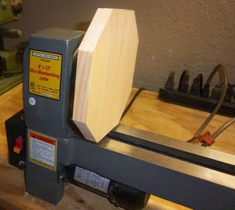

In this step, cut your 1x8 into a perfect square. Then on the back side of the wood, draw an "X" from corner to corner. This will give you the dead center of the piece. Before mounting to your lathe, cut off all four corners to make an octagon. Now, use the center mark to mount to your lathe.

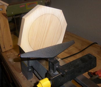

With the lathe on low speed, hold your pencil to the area you want the indention to begin. This will draw a perfect circle on your work.

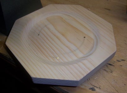

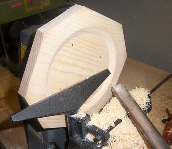

Using your Spindle gouge begin to "scoop" out the middle. everything from the pencil mark to the center. Make the indention gradually get steeper until the center of the arena is the deepest point. This way both tops will try to get to that lowest point and cause them to battle. Otherwise, they will spin in their own area and possibly never collide. What fun would that be? :)
Sand your piece down and put it aside.

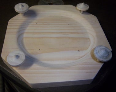

In this step, drill out four holes just large enough to fit the stems. You don't want the fit to be too tight because when you add stain, they may no longer fit.

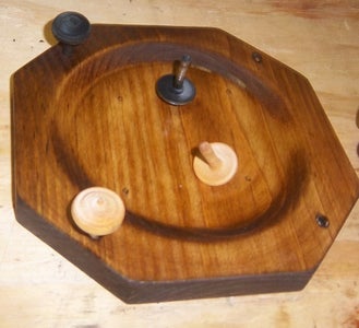

Follow the directions on your wood stain and finish up the project. I used three coats of stain on the arena and only one coat on the tops. I also added one coat of poly urethane when done.
Be sure to stain your two teams of tops different colors so it's easy to tell whose top is whose.
