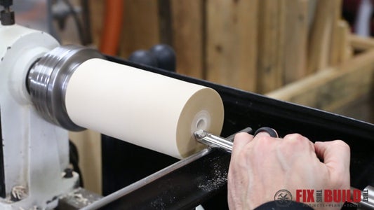

Step 4: Hollowing the Koozie Out (try #1)
To hollow out the blank it needs to be mounted it in a chuck. So I cut a tenon on the end of the blank with the square tool and then under cut it into a dovetail to match the chuck. I took the blank off the lathe and installed the chuck on the headstock and put the dovetailed tenon into the chuck and locked it down.
I'll go through what I did on the first one then show you a better way on the second one I made. I started by using a 1/2" drill bit to drill a hole 4" deep. Then I came back and cleared out the waste with my round cutter. By the time I was done the walls were pretty thin, but the can fit...for now.

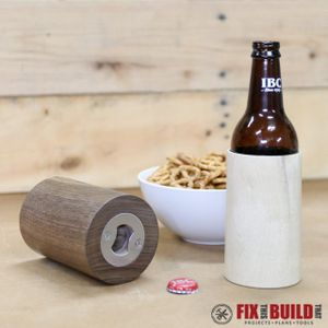

Step 8: Prepping Koozie for the Bottle Opener Insert
I wanted the koozie to serve double duty, so I decided to mount this bottle opener insert into the bottom. The insert needs a couple recesses drilled into the wood to make it work and be flush mounted.
I flipped the koozie around and mounted it back in the chuck this time expanding the jaws into the mouth of the koozie. I used forstner bits again here and drilled a 2" wide recess to flush mount the insert. I also needed to bore a hole to give the bottle cap room to get into the opener.

Step 10: Salvaging the Maple Blank
And back to the maple piece from the beginning, I realized it was the perfect size for a bottle of IBR Root Beer so I finished that one too. Cans are a consistent size, but I found bottles are all over the place. So you'll need to custom fit your bottle koozie to your favorite brew.
