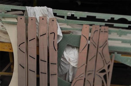

Step 3: Cutting Bench Slats
Since I'm cutting a pattern and decreasing the strength of the wood I chose a dense hardwood plywood of 22mm.
I used a waterjet cutter available at my workplace to get the result. It's a great machine to cut mainly 2D shapes out of basially any material. Fortunately CNC milling machines will do the job fine or even better and these are a bit less rare to find in public workspaces.
The pieces turned out good, they needed some time to dry before moving on to the next step.

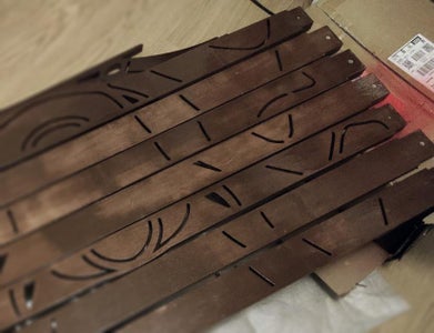

Step 4: Finishing Wood
To finish the slats I used a dark colored wood stain. Two layers were applied which was a bit tricky to get it in all the small crevasses. Once everything is nice and dry I finished it up with two rough layers of clear wood lacquer.
