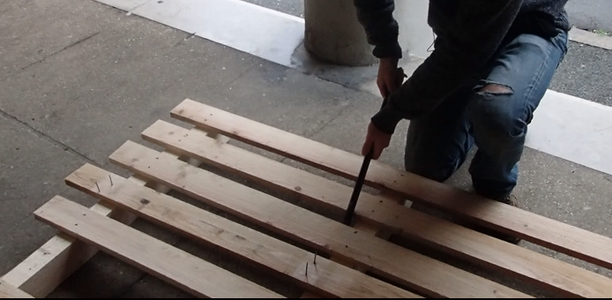

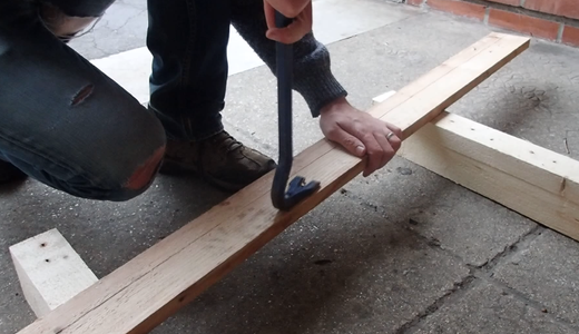

The pallets can be collected from craftsmen or professionals. Bike wheels can be picked up from bike shops.
The pallets can be dismantled with a crowbar and a hammer.

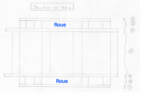

Step 3: Construction of the Wooden Structure
On the wooden structure, there are 4 categories of boards:
- Plates 2 and 4
- The rafters 1 and 3
The structure must be mounted from the center
rafter 1 -> board 2 -> rafter 3 -> plates + wheels -> board 4
Rafters 1 and 3 must be staggered. The rafters 3 must frame the bicycle wheels, so their thickness must be equal to the width of the wheels with plate.
Step 4: Fixing the Wheels
The wheels must be fixed before the boards 4.
The plates can be attached to boards 2 and 4.

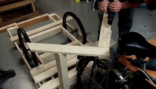

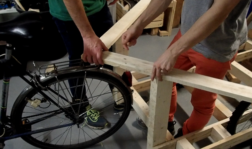

Step 5: Link the Trailer to the Bike
The trailer can now be attached to the bicycle rack. The connection system must meet the following conditions:
bear the load of the trailerwithstand a slight tilt of the bikebe able to be attached and detached easilybear braking / acceleration (bear force in all directions) In our case, we chose to fix the trailer with an inner tube.
