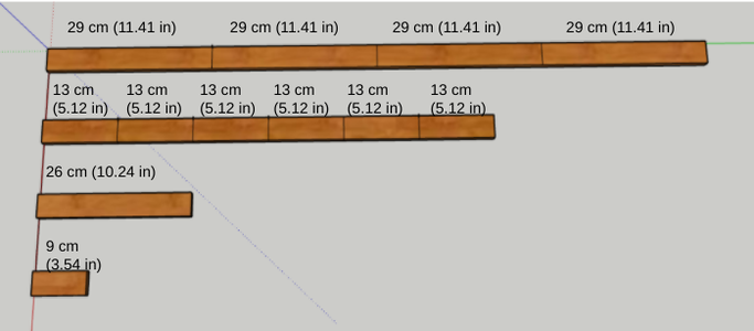

Step 1: Measure, Saw and Sand
Firstly, measure the pieces accordingly to the first photo. Then you saw on the marked lines. Try to saw as straight as you can, obviously. Afterwards, 1 of the 6 pieces of 13 cm (5.12 in) you have to saw lengthwise in 2, an another piece of 13 cm (5.12 in) you have to saw 3 grooves, as in picture 5 (make sure you don't saw through the plank, maximum to half ), to fit in the grooves. The piece of 9 cm (3.54 in) also needs to be sawed lenghtwise in 2,and that piece you have to make into a wedge-like shape ( see picture 4, the upper piece). Round the other side using sandpaper. After that, sand all the pieces, but try to sand it off as little as possible. Only the splinters have to come off. Make sure you don't round the corners too hard. The piece of 26 cm (10.24 in) you must round two corners like picture 6.
