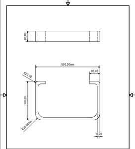

Since I hadn't found any table legs/frames for my table, I ordered them made from a drawing I had made.
I attached this frame to the back plate of the table with metric bolts and nuts I found in the basement.
The places where the holes for the racks were, I reinforced inside with more wood scraps.
I screwed the back plate with the table frames to the main side.
