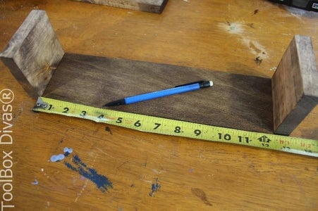

Step 2: Start With the Ends
Attach the 2 sides to the Bottom piece using RapidFuse. Secure with 1” brad nails.
