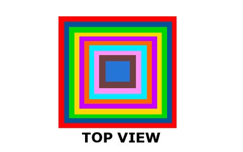

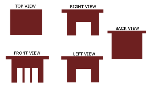

Step 2: ARCHITECTURE
In this step you will need to make a Blueprint design from the picture you have search earlier.
Making a Blueprint is not that easy, you can also ask someone to do this for you in case you didn't know.

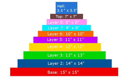

There is a 9 steps on my pyramid and they have a different sizes.
Sizes:
  • Hall: 3.5" x 3.5"
  • Top: 7" x 7"
  • Layer 8: 8" x 8"
  • Layer 7: 9" x 9"
  • Layer 6: 10" x 10"
  • Layer 5: 11" x 11"
  • Layer 4: 12" x 12"
  • Layer 3: 13" x 13"
  • Layer 2: 14" x 14"
  • Base: 15" x 15"
Size of Stairs:
  • Stair 1: 3.5" x 9"
  • you will b needing 4 of this.
Note for the Stairs:
  • The size of the stair is depend in your layer, in my case since i have a 9 layers with a height of 1 inch i add all those layers to get an equivalent of 9 inches height for the stairs and 3.5" for the width because in the upper most part of the pyramid or the Hall is 3.5 Inches.

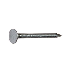

  • Hammer to Hammer the nail into the woods.

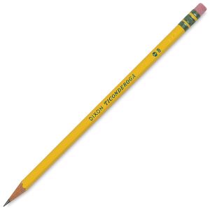

  • Pencil to mark the correct measurements.

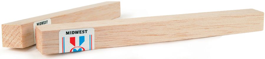

  • 1" x 1" wood in my case i use 0.5" x 0.5" wood to make it more smaller. I didn't the exact amount for this material because it depend in the size of the project.

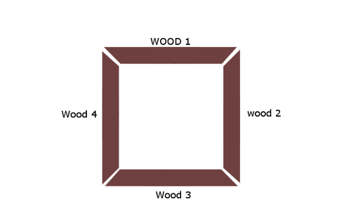

Step 5: Cut the Wood Into Pieces to Match the Layers
Mark the Wood with the measurement of the layer
IMPORTANT!!!
  • In every layer you will be needing 4 pieces of it to make a square.
  • Cut an angle in every corner of the wood to make it easier to bind or to connect.

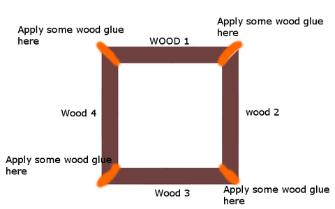

Step 6: Making the Layers
Use your L square to make a perfect 90 degree angle on every corner of the layer to make a perfect square.
IMPORTANT!!!
  • After using L Square apply some wood glue in every single corner of the wood to make it stick so it will be easy to hammer later.
  • Use Sand Paper to make the wood smooth so it won't affect any paint materials.
  • Ask someone to hold the layer so it will be easy to hammer.
  • Do the same step in every every layers.

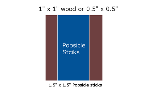

Step 8: Making the Stairs
And now for the Stairs cut a wood with a measurement a total of the height of the layer for example my layer is 9 inch so i am going to cut a 9 inch wood for the stairs, since the Chichen Itza has a total of for stairs in every faces, so you will need 8 cut of this.
IMPORTANT!!!
  • After cutting the wood for the stairs make a cut on vertical direction as shown in the picture so we can put the popsicle inside of it.
  • After that glue the oposicle sticks inside the wood.
  • when you see some holes on the stairs you can use wood glue to hide it just poor some of wood glue into the hole then let it dry.
