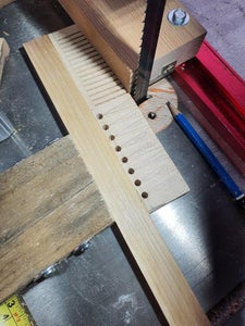

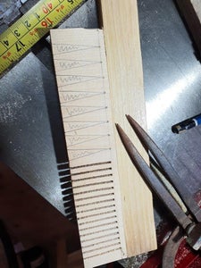

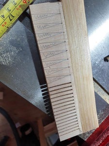

Make a line along the piece of birch approximately 3.5 cm (1 3/8 ") from what is going to be the points of the teeth. Mark the middle of the piece of wood and make a stop-mark approximately 5mm (3/16") from the middle. On the band saw, make a cut from the end wood to the long line approximately 1 cm (3/8") from the end to the line on the side of the stop mark. Then set up the fine-teeth jig so that it is approximately 4.5mm (7/64") from the blade. Make cuts until the stop mark is reached (the picture is from an earlier attempt, so there is no stop mark on the wood, but it should have been just after the last cut). Afterwards, use a compass or ruler to make marks along the long line from the last cut to the end with the spacing of two cuts. Then use the coarse tooth jig to draw lines making points from the edge of the birch to each mark. The cuts should end in a point at each mark but not meet at the edge. (This is impossible to describe in words, see photo).
Using a 5mm (3/8") drill, make a hole at each mark (again, see photo).
Using the coarse teeth jig as a support, cut along the lines, but cut outside the lines to make sure there is wood to sand away.

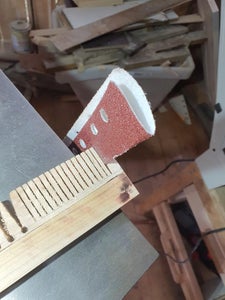

Fold a 40 sanding paper, sand between each of the fine teeth until it runs smooth and the distance between the teeth is approximately the same as the width of the teeth. (this reminds me a lot of something my dentist occasionally is doing...) Sand on the sides of the comb to get the right profile (I used an orbital sander, I guess a band sander would be the best tool for this, but there is (still) not one in my shop)
Use a knife or a chisel to round of the coarse teeth a bit. Then sand them till they are smooth. Sand of the ends of the fine teeth until they are a bit pointed. Until you have learned what works, test the comb. It is very noticeable if it just skids over the hairs or if it works. Make sure that the teeth are not too sharp either.

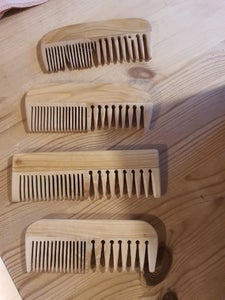

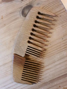

After trying a few times, this starts to work well. The upper comb is my first attempt, made without any jigs and trying to make the entire distance between the fine teeth with the band saw. On the second one, I used the jigs, but I made the ends of the coarse teeth to narrow, so I lost too much length when I sanded them down. The last one starts to be a copy of the initial Russian comb.
