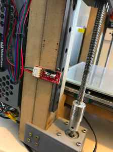

The final part of the axis system are the limit switches (endstops). They are used to home the printer, whereby each axis moves in the appropriate direction until it jogs the limit switch and is 'at home'. After homing, we know the exact location of each axis, and therefore the print head.
To calibrate the z-axis: (1) I used a single (not two, as can be seen originally) screws to hold the endstop in place, meaning I could pivot the endstop up/down for fine tuning; (2) the print bed uses a nut and bolt spring mechanism to level the bed (discussed in Step 5).
For (1): Next time I would use a Z probe which allows the software to do the fine tuning. The z-axis homes until the probe, attached to the print head, detects the optimum distance to the bed.

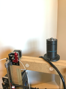

As a beginner, I went for the friendly-looking and cheaper bowden setup. I bought e3D's entry-level Lite6 Hotend, some PTFE tubing, a Nema17 stepper motor, and an extruder drive gear. I designed and 3D printed a part to attach the hotend to the linear guide rail sliding block. I then used a laser cutter to create another part to screw the extruder to the top of the frame. As you may be able to tell from the pictures, I originally positioned the extruder in the center of the frame, but then moved it to the left-hand side to allow room for my on-the-frame filament roll.
I would like to try converting to a direct drive and see how the print results differ.

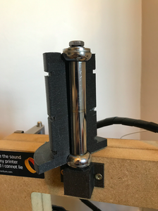

The filament roll: I took apart an old bicycle pedal, which contains the perfect bearings for the filament roll to rotate around. Two 3D printed parts fitted around this pedal axle, allowing the filament roll to sit nicely.
Any system should do, as long as the motor can tug hard enough to unravel the filament. Other setups have the filament roll hanging off a horizontal rod, but this is not so space-efficient.

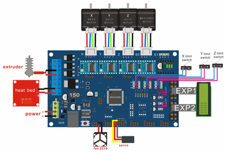

The motherboard is the brain of the 3D Printer and connects to all the electrical components. I was recommended the MKS Gen motherboard (based on the ATMega2560 microcontroller) and it does the job well at a good price. It has five motor outputs, supports 12-24V power inputs, is LCD compatible and can use Marlin firmware (see the next section).

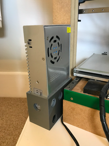

The most important step in the electronics is setting up the power supply. To run off mains, you need to step down the voltage using a regulator and convert to DC. I chose a 12V specific converter (to run the motherboard off 12V), but if using more power-hungry components, consider running the motherboard off 24V.
With power in place, we need to connect the motors, limit switches, heaters, fans, thermistors, and the LCD to the motherboard. We also need to install the motor drivers which convert low current signals to high current output for the motors. I have attached a generic wiring diagram for the MKS Gen motherboard.
I should mention that I connected the two z-axis motors to one connection in order to ensure that they both move in sync. I also connected three DC fans (via a 5V output) to cool the motherboard while in operation.

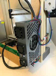

Finally, I enclosed my motherboard and power supply regulator in housings attached to the back of the frame:
