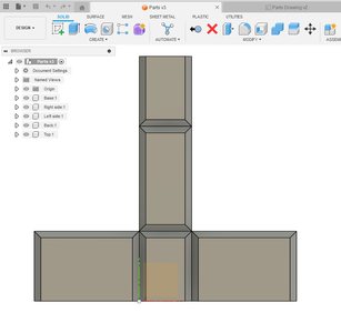

  1. Create the sides of your box. Each side should be 3/4" thick. Dimensions: top and bottom sides - 6x8", right and left sides - 8x12", backside - 6x12". Make sure that all sides that aren't the front of the box are chamfered at 45°.

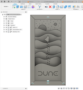

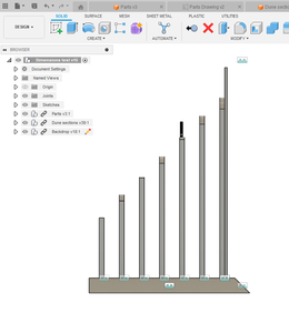

  2. Create your dunes. Start by making 7 rectangles, the first at 3" tall with each 1" higher than the previous. Then create the curved dune shape at the top of each rectangle. Make sure each dune is a separate component. These should be 1/4" thick.
  3. Add footsteps on the dunes. Import a picture of a pair of footsteps and outline it in a sketch. Then create a curved line that those foot steps can follow. Using that line, make a pattern of the footsteps on that line to the amount you desire.
  4. Create a text box on the first Dune. You first need to add the Dune Rise font to your computer. Download the Dune Rise font here. Create a text box sketch and type "DUNE" on the smallest dune piece, making sure it is centered and large enough.

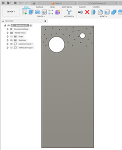

  5. Create the space background. Create a rectangle that is 4.5x10.5". Create a sketch on the rectangle and make 2 circles, one small and one big, for the two moons. Then create a small star shape and copy and paste it all over the section of the rectangle that will be visible. This piece should be 1/8" deep.
  6. Create a walking Fremen. Import an image of this cover of Dune then trace the walking Fremen as best possible. It should be around 1.4" tall, 1" wide, and 1/8" deep.

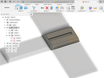

  7. Create section for LED strip. With this box we are going to have an LED strip run underneath each dune piece to light up each gap. To do this, we need to laser cut a section out of the base of the box. Make a sketch with a rectangle that is wide enough to fit the LED strip and reaches from the back to the very first dune. This should be deep enough so that there is no friction with the dune pieces when sliding the LED strip underneath.

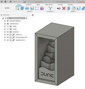

  8. Use joints to put the sides together in a separate file to see how it looks!

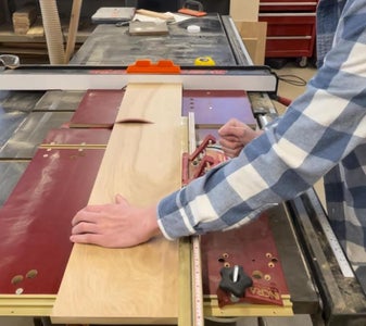

  1. Measure out dimensions. Take a plank of 3/4" wood and measure out the dimensions each side of the box with a pencil and a measuring tape.
  2. Cut sections using table saw. Following safety precautions, use a table saw to cut each side out following your dimensions.
  3. Cut all sides except the front sides at a 45° angle. Use a mill saw to cut a 45° angle on as many sides that fit. Use a table saw for the rest or the pieces.
