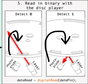

Step 1: System Overview
The purpose of the device is to decode a message stored on a wooden disc. In this step, I'll provide a quick overview of the entire process.
1. Pick a message. I chose messages from some of my favorite writers and musicians to store on the disc. In the example drawing above, I have the classic "don't panic!" from Hitchhiker's Guide to the Galaxy.
2. Create a binary conversion table. If you are unfamiliar with binary information, there are loads of useful books, courses, and videos for learning all about the process. The basic idea is to come up with unique combinations of 1's and 0's that correspond to some action, value, letter, or other entity. For my disc player, I focused on decoding messages. Therefore I created a table that connected 5-bit binary numbers to a character (e.g. 00100 corresponds to the letter "d"), which is attached in this step. The table I created is a truncated version of the 8-bit ASCII table.
3. Convert the message to binary. Using the table I created, each character in the message is converted to binary and saved to create one binary sequence.
4. Arrange the binary on a disc. Now that I had a binary message, I needed to consider how to to store the information on a wooden disc in a way that could be read out by a device. I decided to store the 1's and 0's as non-holes and holes arranged in a circle (just like a CD). Once a full revolution was filled with information, the next data would be stored in another row moving radially outward. I chose to read one bit at a time, so only one detector for data is required. As the disc spins, the holes and non-holes pass over the detector.
But how does the detector know when to read the data? How could I be sure the data detector was reading at the right moment when the hole in the disc was over the detector? I solved this problem by adding a "clock" detector that remains stationary on the device. The most inner ring on the disc has evenly placed holes. When the clock detector registers a falling or rising edge, the data detector reads in one bit of information. The processes listed from 2-4 were all done using Matlab and are discussed in Step 18.
5. Read in binary with the disc player. The clock and data detectors each consist of a laser and photodiode. When there is no hole, the laser reflects off the disc and hits the photodiode and registers a 1. The output of the photodiode is amplified, binarized with a Schmitt trigger, and read digitally with an Arduino Nano. After completing one row of the disc, a stepper motor (Nema 17 Bipolar step motor 3.5V 1A) translates the data detector down to the next row on the disc. The initial position of the rail holding the data detector is determined using a photointerrupt at the top position of the rail. The player consists of a MIDI output, which produces a note each time a 1 is read. Details of the circuit will be described in later steps.
6. Decode the binary and display a message. After the entire disc is read, the Arduino decodes the binary into the message and saves it as a string. The message is displayed onto the Dot Matrix display (MAX 7219).
