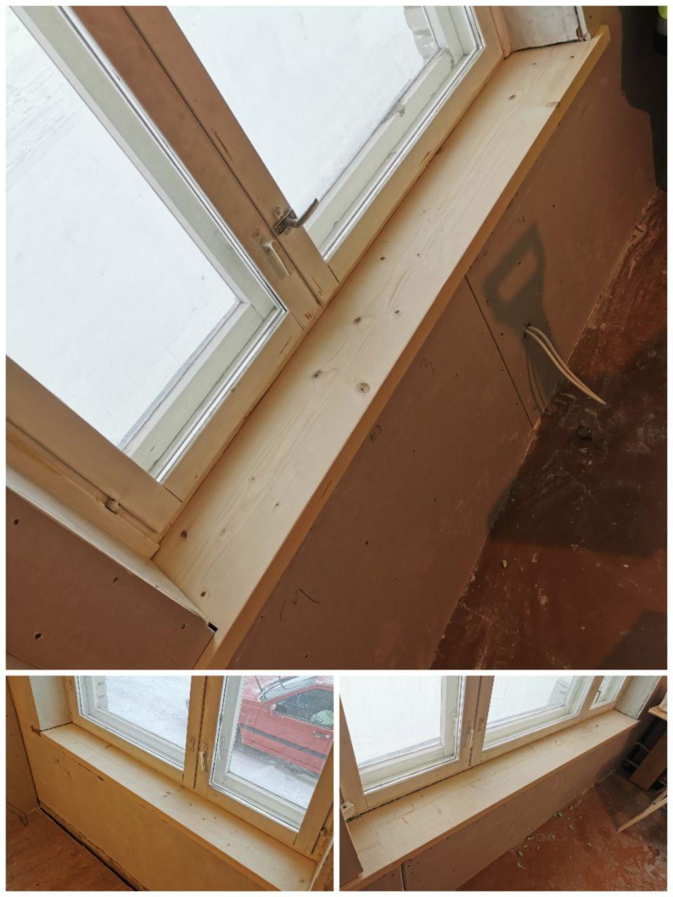

Use some of the woodworking magic to turn the lumber into the desired shape! My choice of magic wand for such purposes is almost always plunge saw with a guide rail. I never fail to get straight cuts with it.
If I am doing a sill with an overhang (which I almost always do) I also use a jig saw to remove the small corner. I still try to make the majority of the cut with a circular saw as it creates a much straighter cut. The jig saw blade tends to wander especially when the wood is over an inch thick (25mm).
As you can see in the last two photos I also cut away the one edge facing the window. This was so it would fit with the profile of the window better. I think it is meant so that you plane the whole board to that thickness but once again I still do not have a thickness planer. I am super happy with the result as the sill ended up being perfectly against the window and no caulking was needed.
Step 5: Install
To install the sill I just glue it down with whatever adhesive (in a tube) I have. Most likely it is a leftover of some sort of silicone. I have also used fast-drying glue but I can't say I noticed a difference. To me, it seems that a flexible adhesive would work better because of the wood movement but I could be wrong.
If the wall is not so perfect I like to use expanding foam and shims in addition to the silicone. The silicone itself I also apply in blobs so to create support pillars. Whatever gets the sill to be firmly in place. Let's just hope no one has to remove these sills any time soon....
