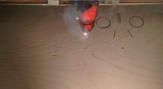

Go to settings and ensure to skip engraving. Choose cutting only. Make sure you select the right settings when you are going to use the lasercutter. Every lasercutter has different settings when it comes to power, speed and passes. Now print your file by clicking ‘Ready’. The lasercutter will start now. In case something’s unclear, check www.youtube.com for tutorials on using Illustrator.
Step 12: First Prototype Made of Cardboard
My first prototype is made of cardboard. This cardboard proved to be to rigid for a google cardboard. Corrugated cardboard or wood is better material to make a google cardboard. I acquired this particular cardboard at a special cardboard retailer.
Step 13: Printing the Illustrator File With a Lasercutter
The illustrator file is printed with a lasercutter. The piece of wood can be acquired at a DIY.
Step 14: Wooden Parts of a Google Cardboard Printed With a Lasercutter
Wooden parts of a google ‘cardboard’ printed with a lasercutter shown above.

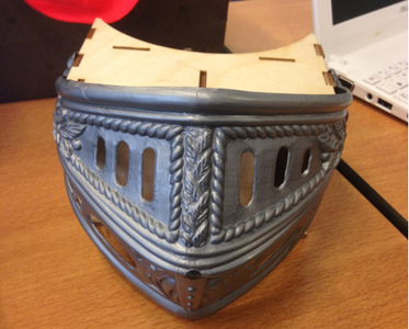

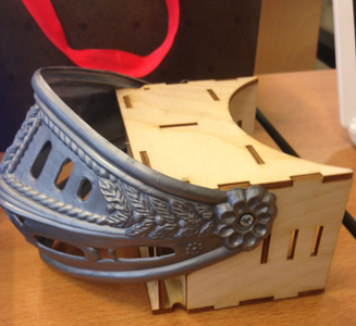

Step 22: Putting a Plastic Visor Onto the Wooden Google Cardboard
To prevent the smartphone from falling out of the side of the cardboard, I came up with the idea of putting the plastic visor of this toy helmet onto the cadboard. The visor is attached to the cardboard with metal screws. Every visor will do. As an alternative, one could attach velcro on the side of the cardboard. I bought this toy helmet at www.bol.com .
I choose a new purpose for the visor, because I will use it as a smartphone protector, and by using a knight’s helmet I add a historical feature to the glasses.
Step 23: The Wooden Google Cardboard With a Visor Attached
The end result, the wooden google ‘cardboard’ with lenses and a visor attached.
