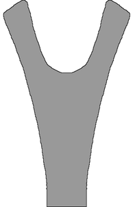

Step 1: Create the Template
I created the template on my computer and printed it out on self adhesive paper. I stuck it on a scrap piece of MDF and cut it out on the band saw. I then used the belt sander to smooth and better define the edge.
I created a template to make it easier to mark out the blanks but also if I use a softer wood I could use a pattern bit in the router and follow the template exactly. Unfortunately the Olive Wood seems to splint when I router the end grain so that was out of the question for this project.

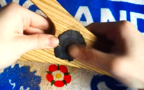

Step 4: Create Beats Logo Inlay
I used a mini rotary tool, similar to a dremel tool to create the logo in the wood. I marked on the beats logo and made sure to remove all the wood I needed to so it was below the surface of the wood I wanted to keep.
As you can see in the picture I left the 'b' of the logo and removed the circle around it.
I then filled the space with Milliput Epoxy Putty. I just mounded it on the area because it will sand away easily after it is fully dry.
After leaving it over night it was fully dry and I used my belt sander to sand down the mound og Milliput until the logo was crisp and clear to see.

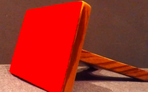

Step 6: Finnish
For the finnish I a gloss spray polyurethane. A spray lacquer would have worked fine but I already had the spray poly.
I gave it 3 coats and sanded between each coat to create a smooth finnish.
I then added a piece of red felt baize to the bottom to make it look and feel more profesional. It also helps to stop it scratching any surface it is put on.
I just used a spray adhesive to stick the felt on.
