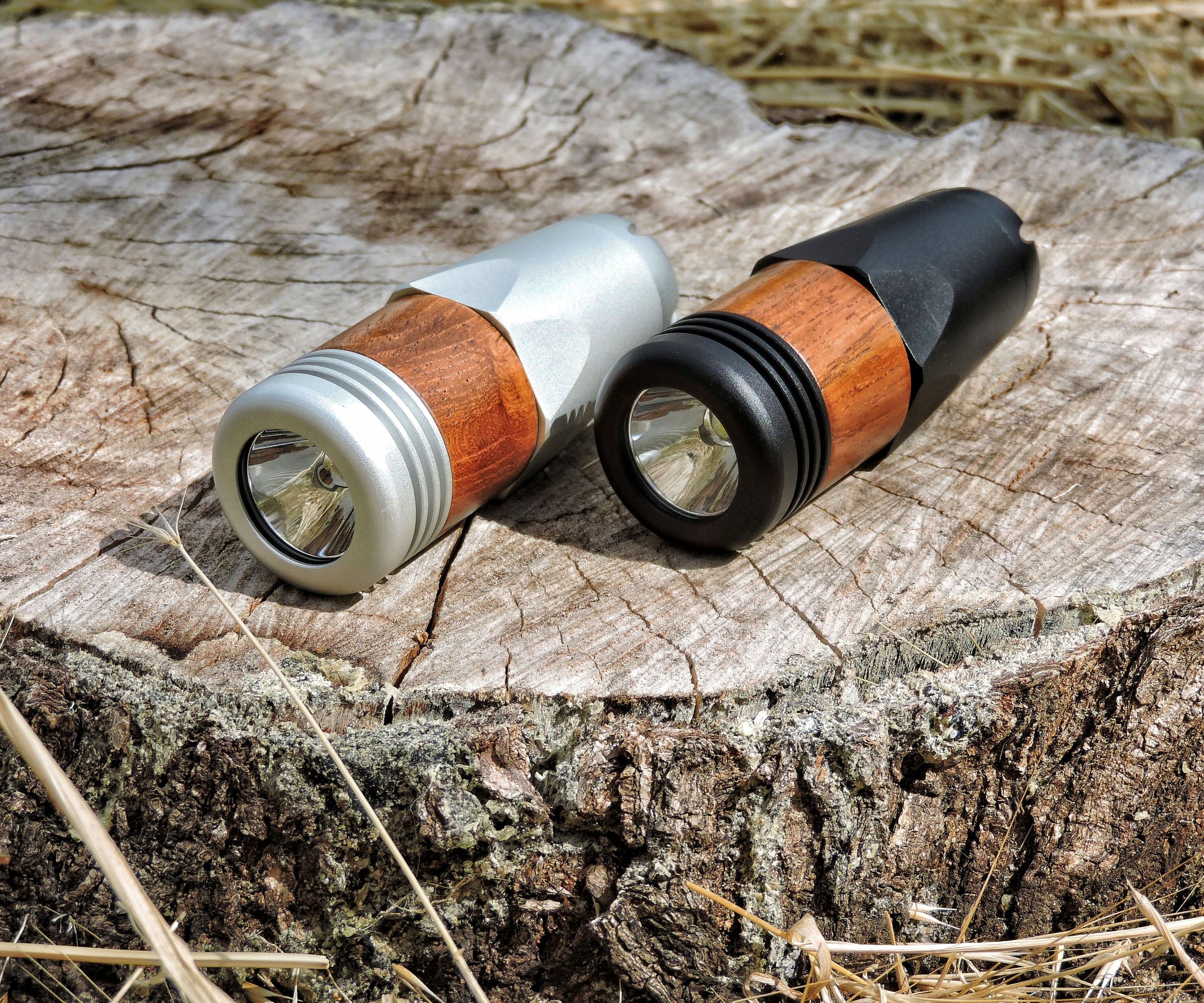

I have always been fascinated my the beauty of real wood incorporated into products and in particular everyday carry tools. I noticed a lot of wood incorporated into EDC products, especially knives on the market, but have not yet seen many flashlights with this. This inspired me to make my own and the following project is an all wood exterior flashlight with an aluminium internal heat sink powered by a high power CREE LED and a fully USB rechargeable lithium battery. It has a rear wooden plug that gives access to a USB rechargable socket.
This flashlight is obviously not a strong as other flashlights, it was more of a fun experiment to make something that looks nice. After making this light, it has inspired me to continue my designs and make a more practical and stronger flashlight that incorporates the real wood feature.

First things first I needed to choose a type of wood for the body of the flashlight. I decided to use Canadian maple for it's nice grain pattern and it also has strong density. This will allow for turning the wood with thinner walls and keep a nice grain for the overall look
Step 2: Fine Turning the Wood
The work for this wooden cylinder was done using a lathe. It was then hand finished on the inside to allow for a thinner wall to be created and specific dimensions to be met for the insertion of different hardware. It was important not to make the wall to thin so the wood didn't split and crack. Luckily the maple allowed for quite fine tuning in this area.
