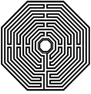

Step 2: Labyrinth Design
Because I already had my pattern, I‘m not delving into the details of developing a new pattern from scratch - that would make a new Instructable - but focus on designing the board with the pattern I have.
Since I had decided to make another labyrinth, and in wood this time, the question remained: How?
So let‘s get started:
A typical Christian pattern is round. But, bending wood, though possible, is tedious and takes some time and you need lots of sections with different radii - simply not practical, i.e. impossible.
Doing the Amiens type labyrinth with 1 cm wide paths would result in a total size of at least about 50 cm diameter, which is a bit large and unwieldy for a kitchen top.
Thus, I quickly ended up using my old pattern and adapting it to an octagonal shape. Why not a square? Because I had drawn the pattern first (years ago) as a square, and an octagon is much cooler - though more difficult….
Preserving the Chartres proportions, I would end up with a roughly 40 cm diameter pattern - perfect!
Year ago, I had the chance to do a bit of stained glass work. At the time, I found it best to draw a full-size pattern, cut the glass and use the drawing as the template. This way you always see where pieces are missing and can judge quite well how well things will fit.
So I decided to do the same with the labyrinth. Also, it made it much easier to calculate the required lengths of wood needed for the project.
As mentioned above, if you want to draw a Christian labyrinth, it is best to draw your basic pattern first - like the Greek Key (meander), but larger and more complex. You can see my pattern on one of the pictures.
If you want to stick to the basic cross, your pattern needs to be splittable into 5 sections and you want all the switchbacks butting against these cuts. If you want to do a pentagram, you need a pattern with six sections, and so on…. That is, because the first and last half-section will end up back to back, making up one complete section.
The center in a Chartres labyrinth is about ¼ of the total diameter, so I planned to do the same. From there it is a simple calculation and you just need to draw an octagon of the matching proportions on your paper. I decided to have the wall separating entrance path and path to the center as the dividing line of the labyrinth, i.e. center of the cross.
Once you have the octagon with all the paths, you can easily transfer the five sections of your design to the four sections around the octagon and connect the lines.
But, for me, this actually showed that the center needed to be enlarged, because the switch-backs would not fit on the straight sections available for the entrance to the center - more erasing and drawing. This shows again, that it does make sense to draw a full, maybe even life-size, model to see if things will actually work out.
With the drawing complete, you can also decide how you want to orient the grain in the turns of the path - should they orient perpendicular to the normal, or parallel, should the ends be cut at 45 deg angles….? The same with the triangular corners that you will need to square the octagon.
