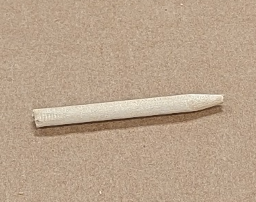

Measure and cut a 2-inch section of wooden dowel.
Use a pencil sharpener to put a point on it. The point does not need to be particularly sharp.
