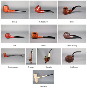

Step 1: Pick Your Pipe
Pipes come in all shapes and styles. The standard pipe components are the reservoir and the hollow tube leading to the mouth.
The shape directly correlates to the difficulty of the project. If the stem is straight or if the mouthpiece doesn't flatten the project would be much easier and different from the bent billiard pipe I make in this tutorial.
