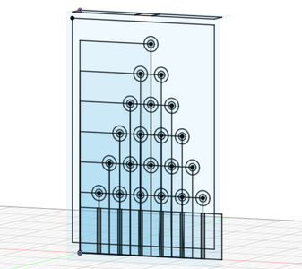

Step 1: Sketch the Board
The first thing I did was find the diameter of a marble which is 1/2 an inch and created my game around that size. In total the board is 8 x 5 1/2 inches with 1 inch between each peg.
Step 2: Sketching and Extruding
I used rectangles to find the coordinate of where each one of the circles needed to be placed and made one circle with a diameter of 0.25 inches to be extruded in the front and another circle with a diameter of 0.5 to be extruded out the back and used to pull out the peg so you can change the direction of the marble.

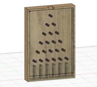

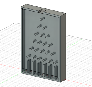

Step 3: Finishing Touches
After extruding all of the pegs I added both the ceiling to drop the marble through and added a little border so the marble couldn't slide out of the board as well as a little opening at the bottom to pick up the ball from. After that I made it wood and I was done!
