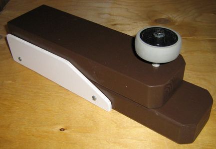

Step 5: The Finished Polymer Clay Kneader
The finished Polymer Clay Kneader with a box of Super Sculpey and a block of Premo for size reference.
I painted the side panels white and secured them with screws (I did not use the washers pictured earlier).
Now it looks like a giant stapler.

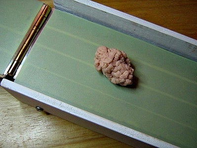

Step 6: The Process:
I grabbed a bunch of minced clay from the plastic lunch bag and squeezed it together and put it into the Kneader.
You'll note the green tone. The clay was being coloured gray by the aluminum flashing so I covered it with pieces from a green plastic binder held down by two-sided tape.
Second picture: First mashing.
Third picture: Fold the clay and crush again. I have it backward in the kneader, the fold should go next to the hinge so the air bubbles will be pushed out.
Fourth picture: After 9-10 foldings/mashings a nice smooth pancake of clay. And my fingers don't hurt.
