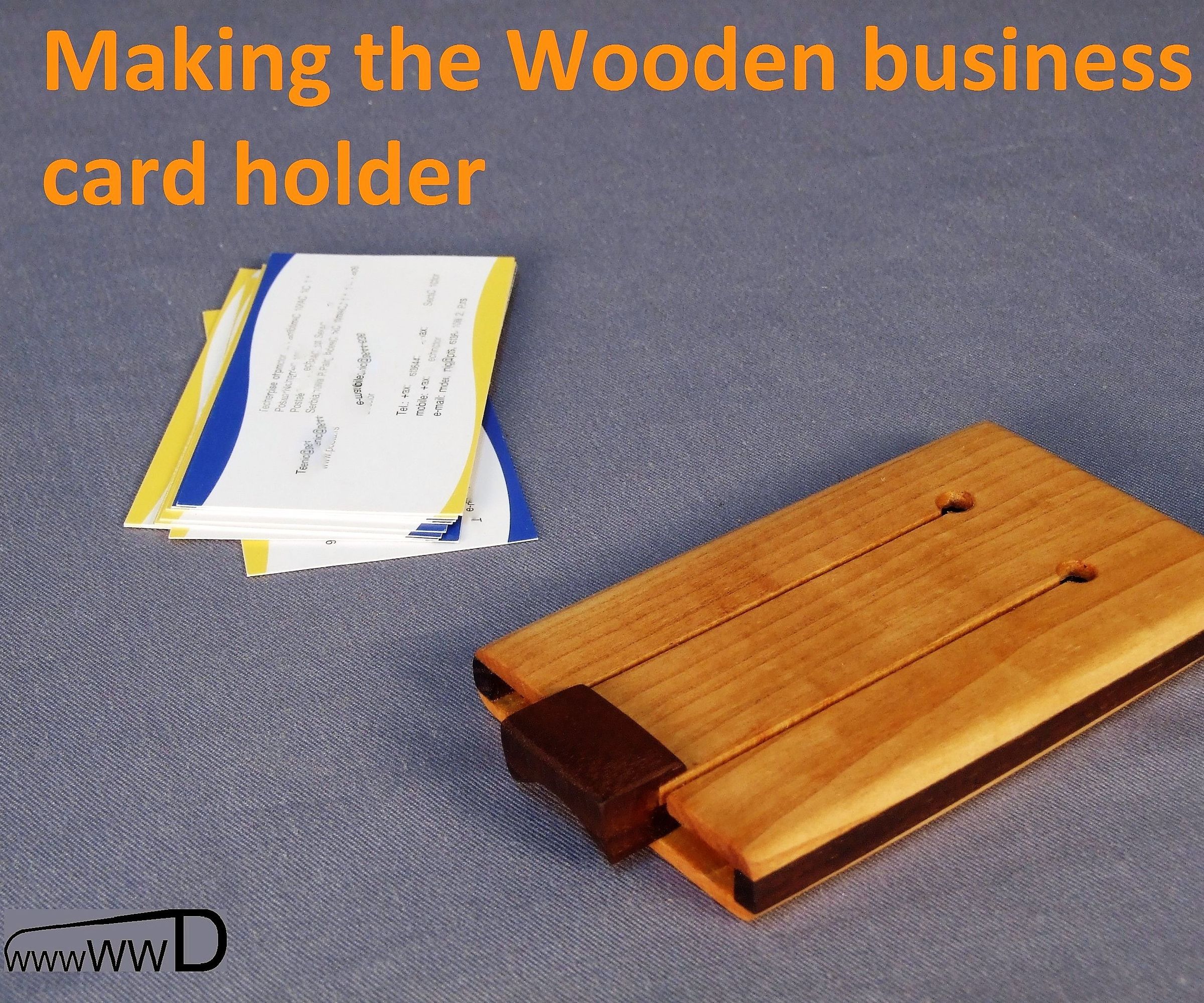

If You need an idea what to make for someone as a present, here is my litle sugestion. Wooden purse is made from walnut tree and genuine leather. Dimensions are: 173×92 x 32 mm (6,81×3,62×1,26 inch). The pages are connected by wooden hinges, and the wooden purse is closed by 4 magnets.The inside of the wooden purse is designed to hold 4 payment cards, paper money and a mobile phone.

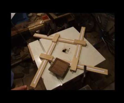

Using a table router, we gradually hollow out the insides of the sides. Then, using a band saw or a hand saw we cut the frames for hinges into which a 4 mm thick wooden tile is placed. Into these frames we are placing the hinge plates and pierce holes 6mm in diameter. Then, round the edges of the sides around the holes so that they do not cling during opening / closing. After that, we remove the layer of wood in height equal to the thickness outer parts of the selected leather (in the illustrated case it is 1.2 mm), so that when the leather is placed, it is at the level of the wooden pages.
