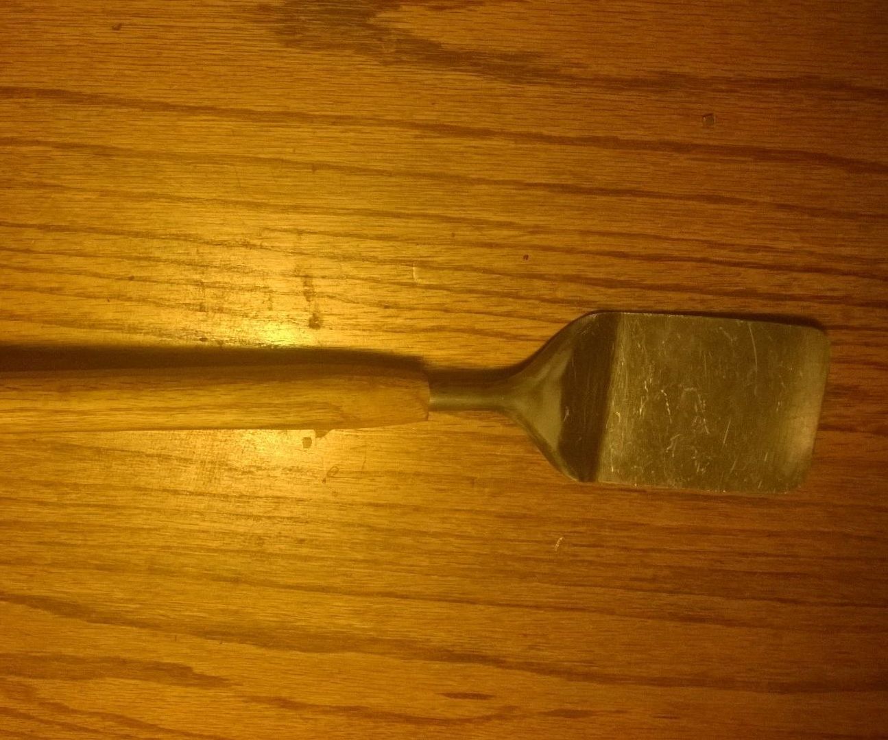

When I was done with the routing, I went back through with the chisel and touched up the perpendicular walls that were often a little screwed up. I also tried to clean up any circular marks that the spinning cutter left (such as the ones in the photo).
