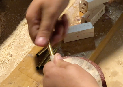

Step 3: Drilling & Gluing the Tubes
In the last instructable I did showing how to make an acrylic pen I used a drill press for this step. That would work fine but my drill best in very cheap and the holes werent straight. So I picked up a jacobs chuck to drill the holes in the middle of the blank. If you wanted you could use a hand drill to do this step with a 90 degree angle clamp.
I then scuffed up the brass tubes with 80 grit sandpaper so the ca glue would stick to it. I used medium ca and pushed the brass tube just under the edge of the blank.
