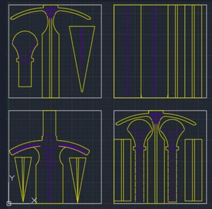

Step 1: AutoCAD Design
The sword is constructed out of three layers of wood: there is one large middle/base layer and two smaller front/back panels. The first step was to draw the panels in AutoCAD. AutoCAD is a computer software in which you can make 2D drawings. In this case I used it for laser cutting, but it has quite a broad range of applications. I searched the internet for images of the sword and the inscriptions on the hilt, then sketched my own 2D version of it on the software.
Step 2: Laser Cutting
The next step was to prepare the panels to be laser cut. Since the sword is about four and a half feet long, it would not be very practical to laser cut all at once. Therefore, I split the three large panels onto four 11”x11”x1/8” boards and laser cut them separately. I divided the panels so that the seams of the middle/base do not align with the seams of the front/back; this will help uphold the structural integrity of the sword when it is constructed.
