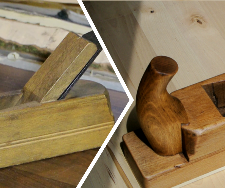

I have a set of heritage wooden planes but it wasn't complete until I found this toothing plane that fit my other planes nearly perfectly online. If you wonder what a toothing plane is - It's in principle the same as a normal plane but the iron is cut into fine teeth at the tip.
It's used for veneering to create a larger gluing surface or when you get tear out with a normal plane. Some people even abuse it as scrub plane as it's relatively easy to push through wood even if the blade is set deep but that's not what it is meant for.
The blade is usually mounted very upright. This makes it rather a scraping than a cutting plane.

Step 1: Sanding the Sole
Before you begin you need to take the plane apart. Use a wooden or plastic hammer and hit on the plane's top. Wedge and iron will get loose then.
The first thing to look for is the sole. Is it out of level, does it have deep scratches or is the mouth too wide? Fortunately mine was pretty fine so there was no need to put a new sole on.
For the main sanding I glued abrasive paper of 80, 120 and 240 grit to an old piece of counter top. You can use double sided tape but this creates small steps if the stripes are not put really close to each other. So spray adhesive may be the better choice here.
I used a combination square to check if the sole is in level with the rest of the body and found that one side was a bit tilted. So I needed to be aware of this fact when I took care of the sole.
The first sanding was done on 80 grit. Make sure to hold the body straight and control of the sole is still levelled from time to time. High spots show up as brighter wood and you want the sole to have one colour all over in the end. It's okay to have some low spots at the sides though as you will create a bevel there later anyway.
It's pretty common to have a low spot a the mouth. If removing it would mean taking down too much wood from the rest of the sole you can insert a patch there.
Continue on 120 and 240 grit. If you can't identify if you are sanding evenly you can make pencil marks on the sole.
When you are done so far you usually have very sharp edges on the bottom. These can catch on wood and leave scratches when you work with the plane. So you lift the plane slightly up on one side and grind a bevel all around the bottom. One way to do achieve a very consistent result is put the plane on a ruler with one side.
You can also round the back of the mouth with a small file for the same reason. The mouth's front needs to stay sharp though to keep the wood down as close to the blade as possible.
Step 2: Sanding the Body
I didn't like the dark colour and so I decided to simply sand it off. This also removed the paint stains and allowed me to straighten the tilted side.
Sometimes the handle of these wooden planes is loose. Removing it completely makes sanding a bit easier and it can be glued in with epoxy afterwards. Mine still sit pretty solid and so I decided to keep it this way and pay for it with some more fiddly hand sanding.
The wood smelled a bit moist so it may not have been stored in a dry space but it was in good condition.
After the first pass I repeated the same procedure with 120 and 240 grit and did the same to the wedge.
Finally I washed away the sanding dust with soaking wet cloth and set the plane to dry for a while.

Step 4: Finish the Wood
The wood had dried now and so it was time to get it finished. Loose fibre ends created a fluffy surface and I used 400 grit sanding paper to remove them. The result is already really smooth.
I then used a cloth to rub kettle boiled linseed oil (KLB) on the wood. The smell is really nice and it lets the original colours of the wood pop with a shine of honey. It could soak up quite a bit. Just make sure to remove any excess before you let it try. Otherwise it gets sticky.
I use rubber gloves as the modern version of KLB contains adhesives that aren't the best for your skin. Also don't forget to drop the used cloth into water. It may self-ignite otherwise!

Step 7: Assembly ... Finally!
To get everything back together I put the plane on a flat surface, slide in the iron so that the teeth point to the front and insert the wedge. When I then tap in the wedge with a wooden hammer it usually already sets the blade to my desired depth.
You need to control if the blade sits straight by looking along the sole. You can adjust it by hitting the blade sideways with a hammer. You can use a steel hammer if you like. Even if the top mushrooms out there is still plenty of room for the wedge to lock the iron correctly.
If you want a deeper cut hit the iron directly on the top and if you want less hit the body on the top or the back. Note that in the latter case the wedge loosens as well and needs to be tightened again.
I am really satisfied with the restoration. The grain of the wood came out very nice, you can even read the old owners mark now, I discovered the blade's brand and most important it's sharp again and it's a joy to work with the plane.
